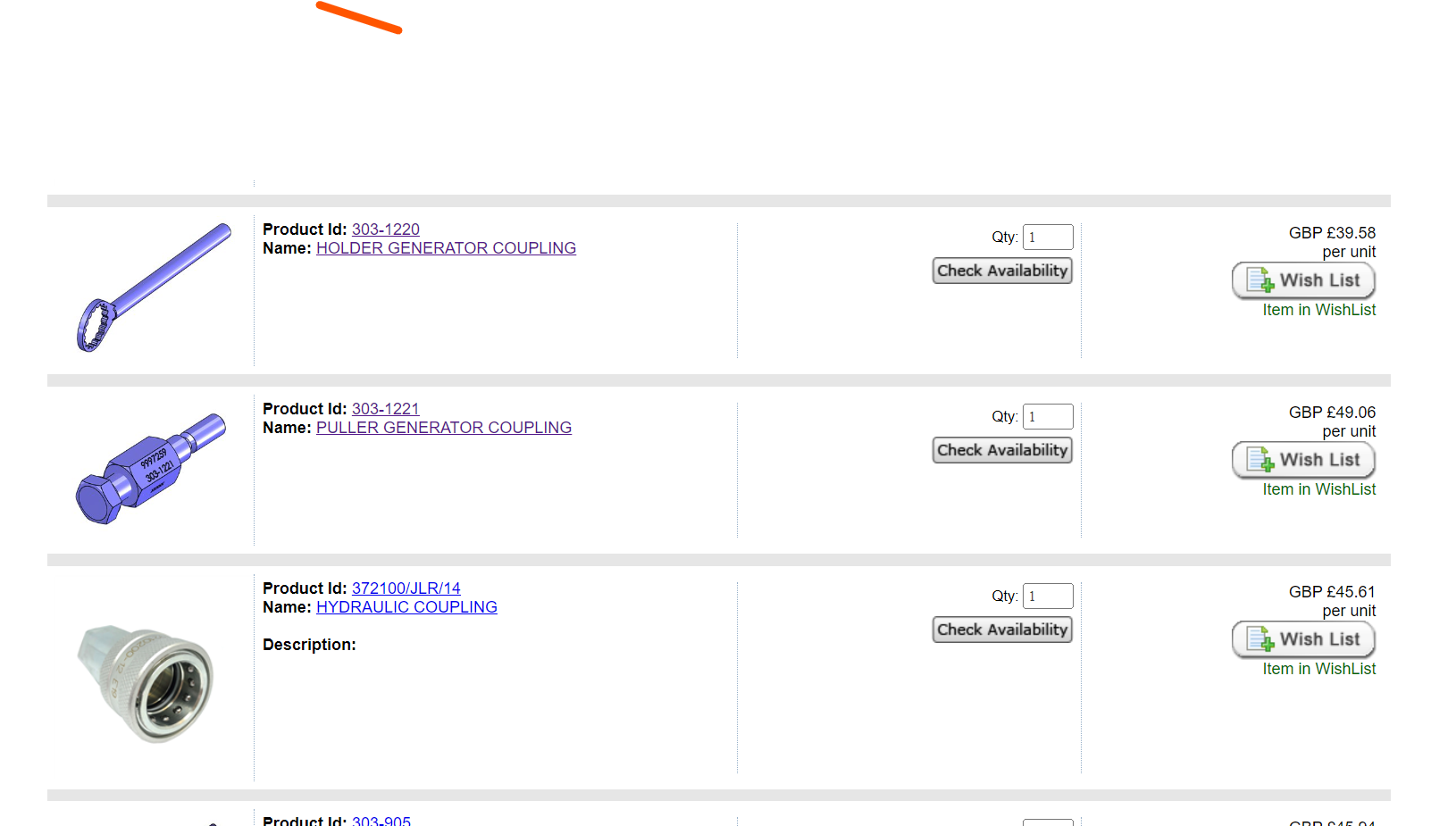

Reading through the cylinder head removal steps, it looks like I will need to acquire 3 new specialty tools in order to remove and install the Alternator (aka Generator). The only places I am seeing that I can get the tools mentioned in the manual in in the UK. Is there somewhere I can look that would be a little closer to home in the United States?
Old Dec 30, 2023 | 04:08 PM
flybd5's Avatar
Joined: Jan 2020
Posts: 2,152
Likes: 631
From: Massachusetts
Did your try your local LR dealer and eBay? At any rate, ordering from the UK is no big deal. Shipping is usually efficient and fast. I've ordered several things that way, including the upgrade to dual radiator fans for my 2008.
