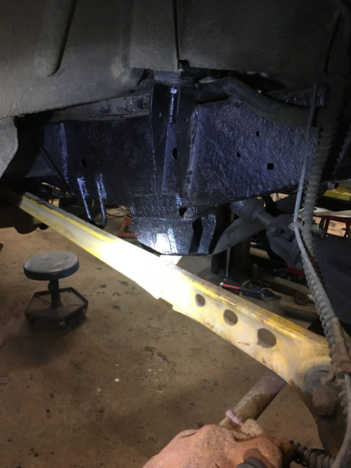

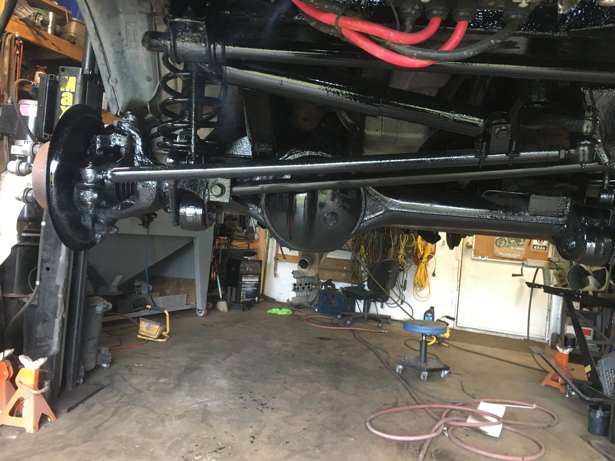

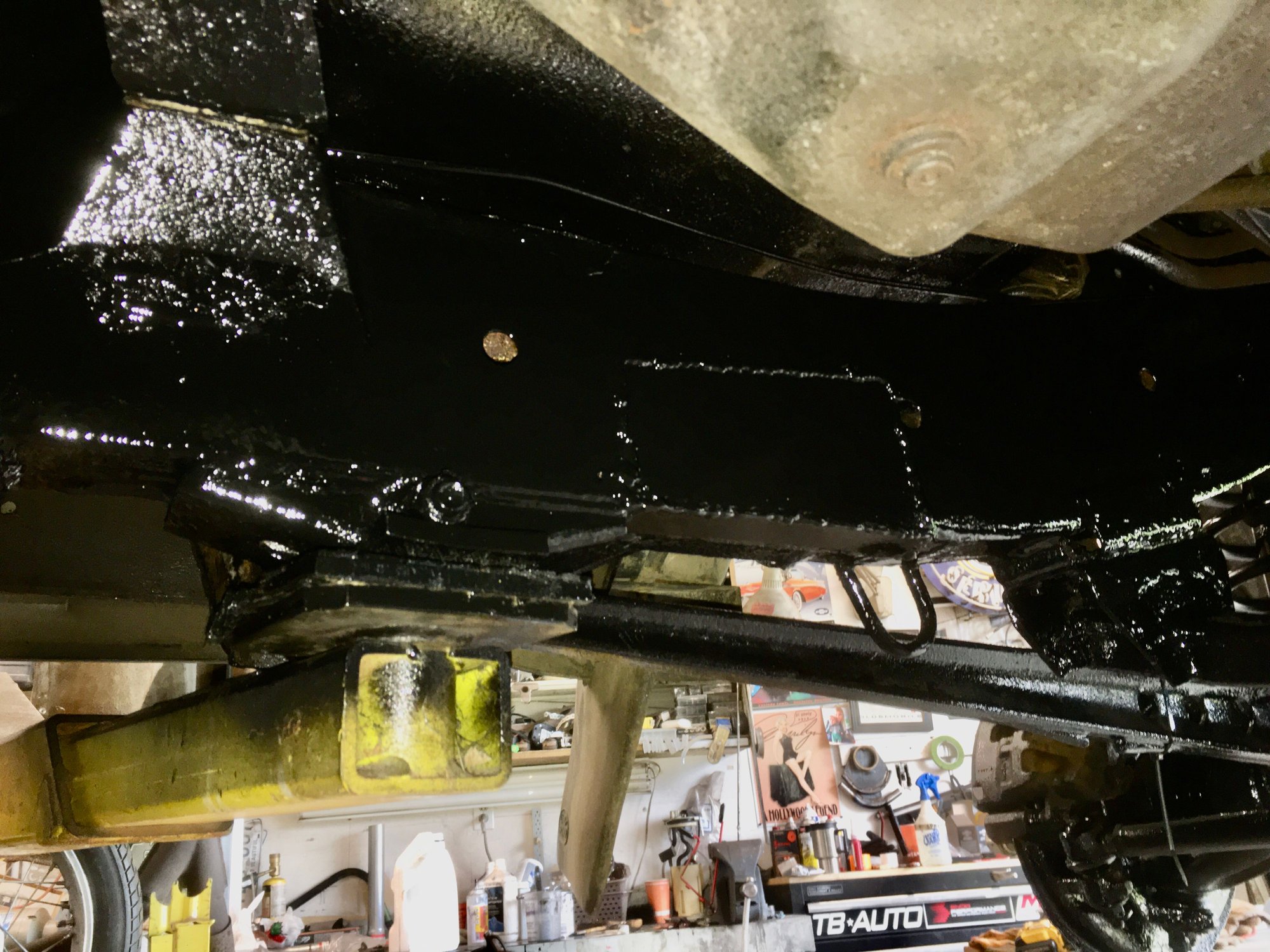

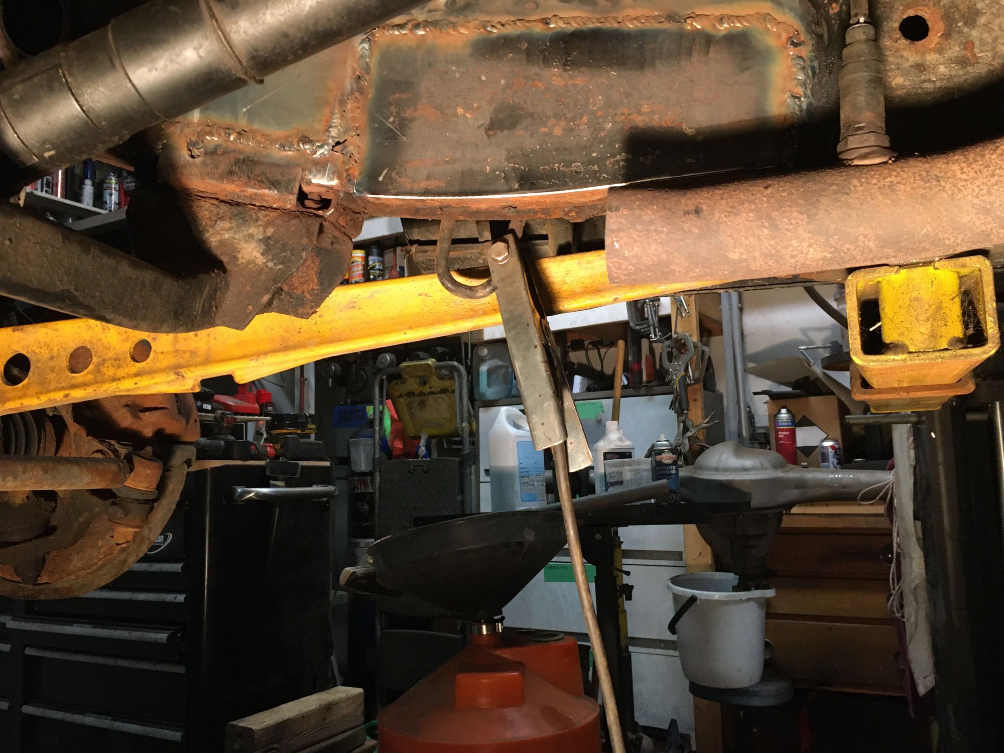

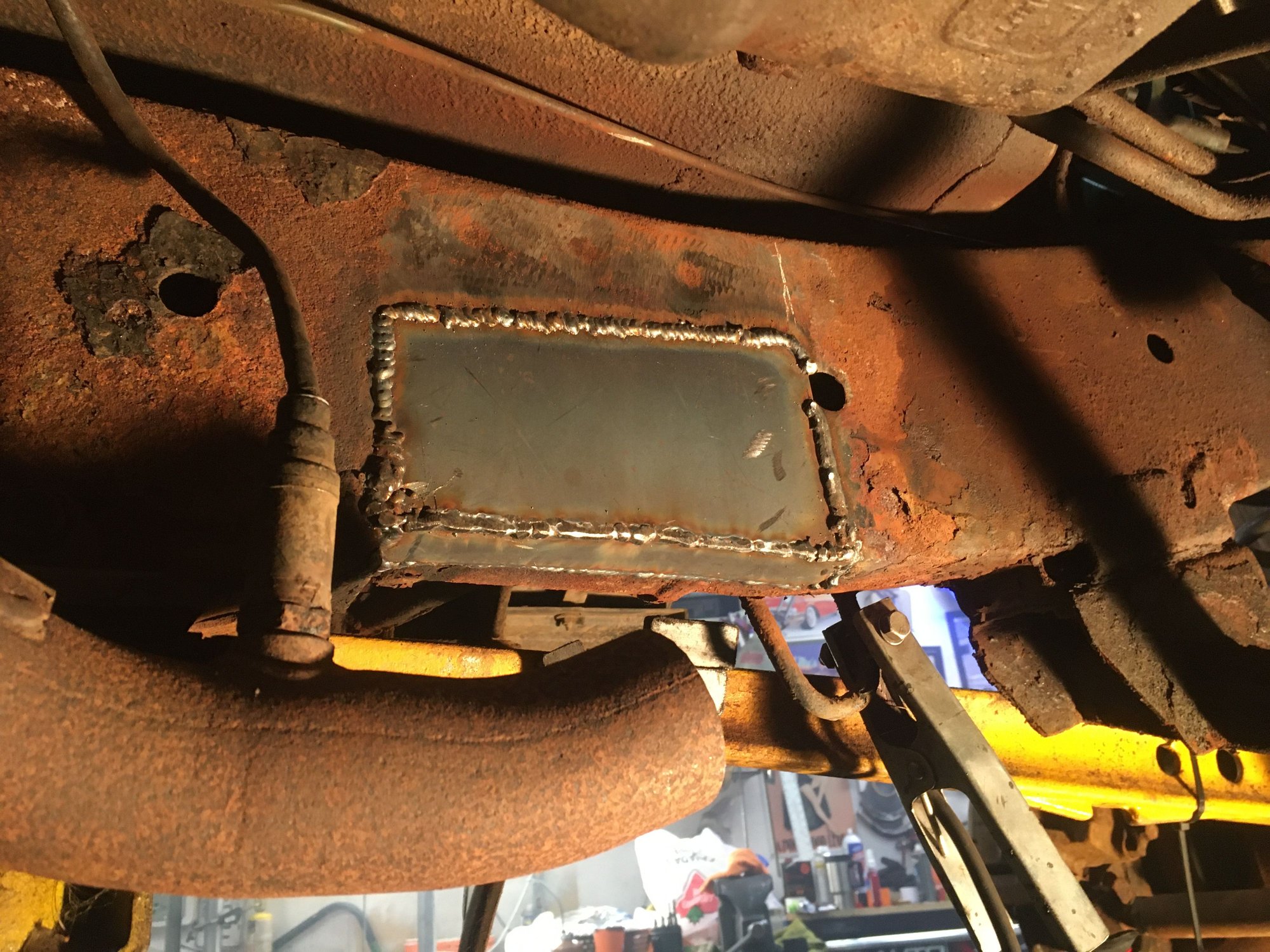

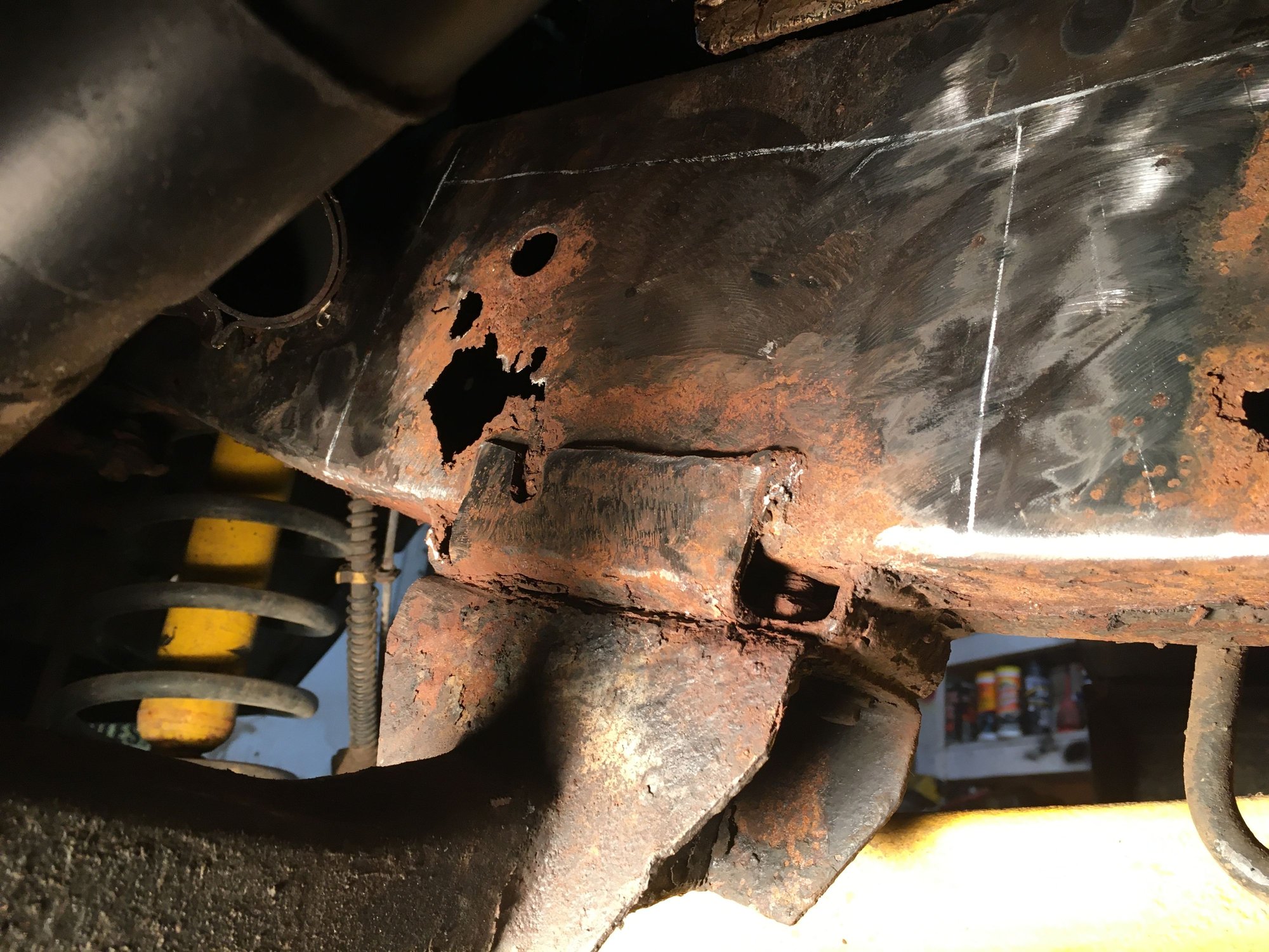

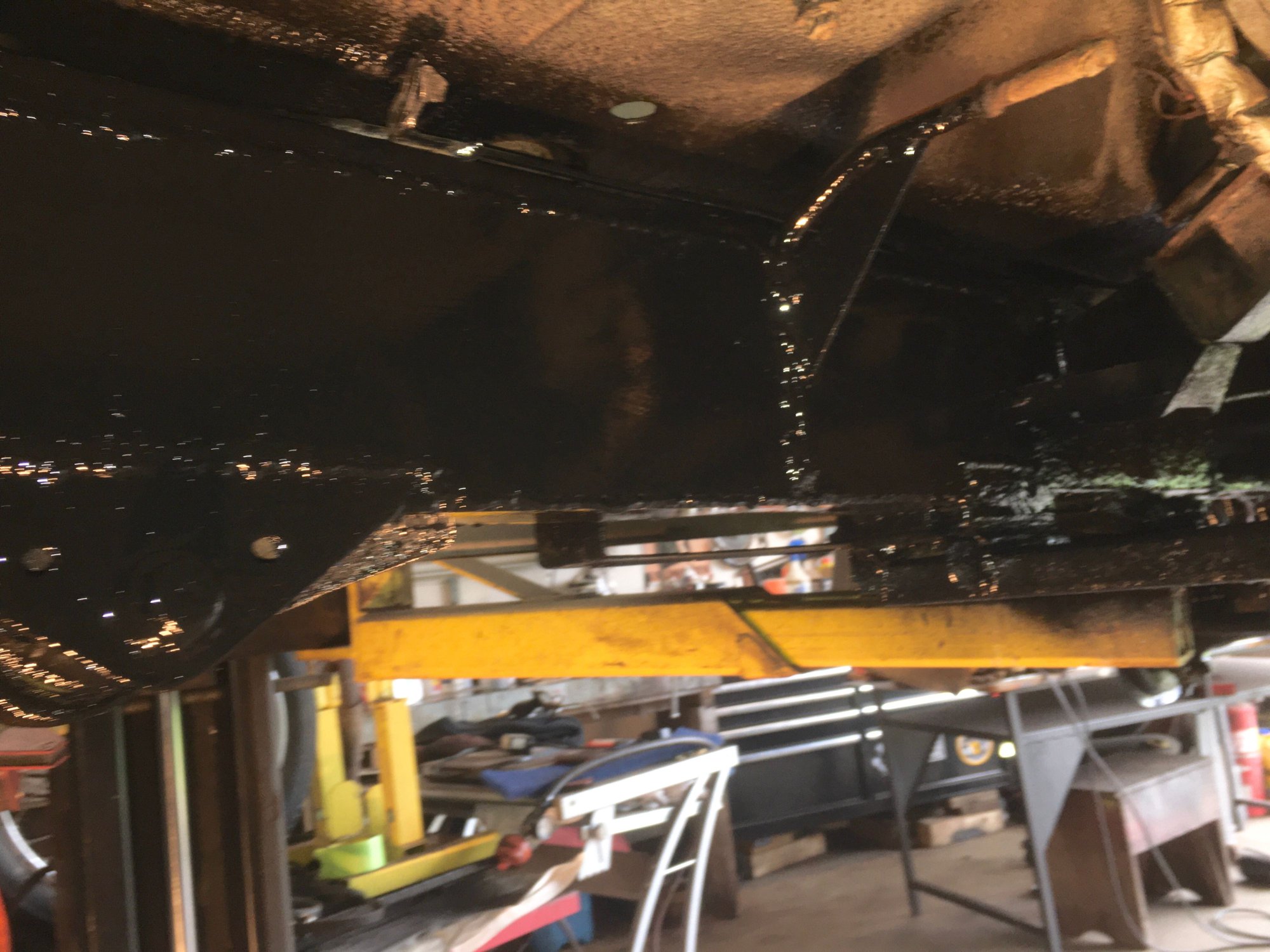

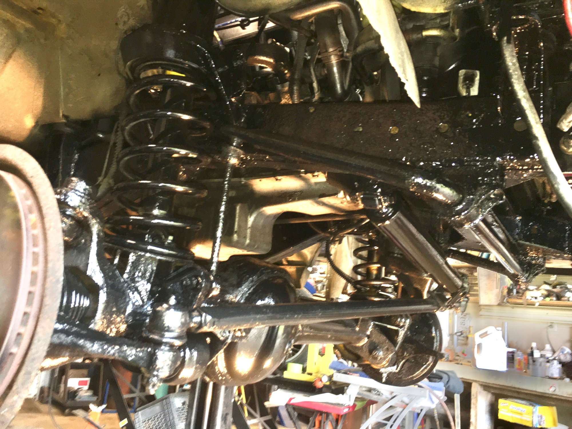

Removed cats exposed 3large holes bottom of frame then decided to wire wheel whole frame found another in drivers side inner patched all with 14 gauge used a good metal rust stop worked well all nice black metal mixed rustolyum gloss black thinned with acetone hardner and sprayed all. Tomorrow install exaust minus cats spacers in back co2 censors see what’s next.
