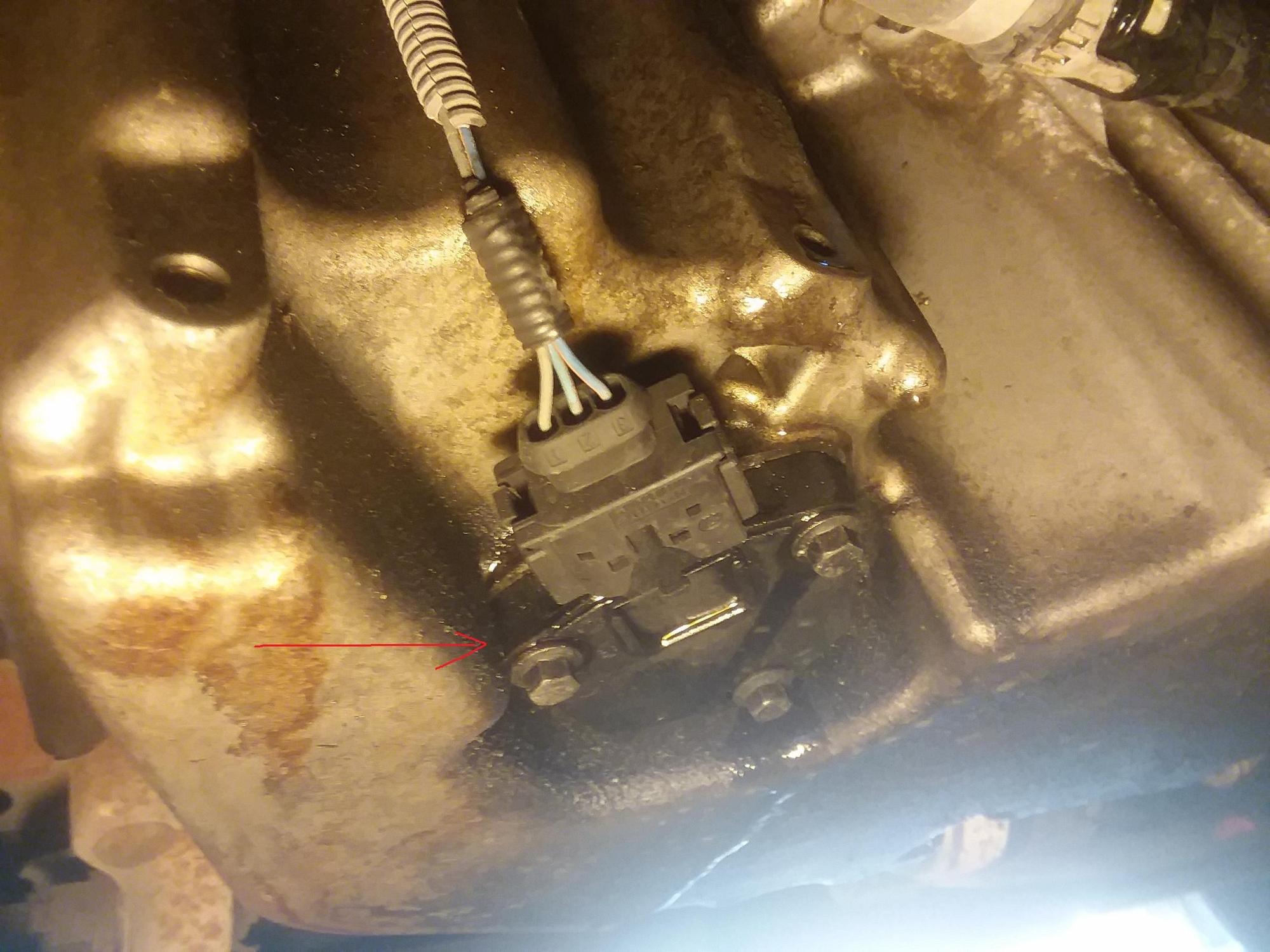

I already tighten the 3 bolts and it's still leaking fluid. What part is this? It only leaks several minutes after the engine is turned off. Please see the pic red arrow pointing to the leaking part.

That is an oil level sensor. It has a gasket. Tightening the bolts when it leaks will not stop the leak. Changing the gasket will, if it is not the sensor that is leaking. If it is the sensor the part number is LR004256 and it costs between $180 and $215.

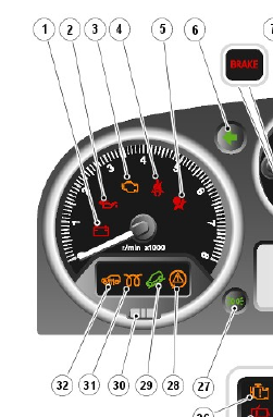

Never seen this one light up when you first start the engine and then it goes out?
Should be the indicator labeled #2.
One interesting piece of info is that if the oil pressure sensor fails the ECU switches to monitoring the coolant temperature. Not sure what the logic is on that one, but there it is.
