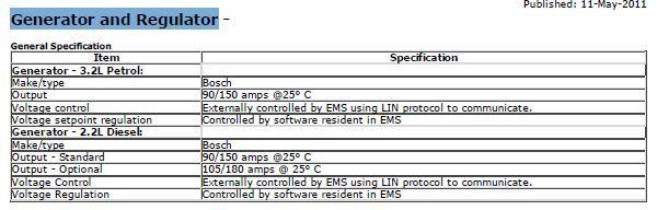

Someone isn't giving me the correct information
BOSCH the maker of the Alternator and the owner of the specifications says 180 Amps
LAND ROVER Service manual calls out 150 Amps
I need some independent data
I went to the VIN DECODER and here is what I found for my 2008
Headlamps - A.F.S. Headlamps [064DS];
Special Fuel Tank - Onboard Vapour Recovery [046AE];
Alternators - Current (Amps) - 150Amp Alternator [058AL];
Door Locking - Operation - Single Locking [076EJ];
150 AMPS for the win
I am surprised that the Germans got it wrong and the Brits got it right.
We are still orbiting the Sun and not the other way around................correct????
For reference if you want a rebuilt 150 Amp BOSCH (Remanufactured by BOSCH) then search for a 2008 VOLVO S80 3.2 and you will find BOSCH AL0848X

Thank you so much for finding that out, it's exactly what I needed to hear.
​​​​​​​ On a different note, I don't know if you have been reading the post to prior to the alternator but I also have a p0087 that keeps popping up. I've done a hard reset it cleared it for the moment but it come back. It's only a problem when cranking the Rover. Once it's running has no problem whatsoever. I don't think it makes a difference cold or hot. Low pressure fuel rail. I've seen other discussions but they were three parts that were discussed which were evap purge valve, fuel pressure sensor and fuel rail pressure sending unit. What would be your take given the circumstances given above?

Interesting info from Paul.....I was under the false impression that if you had the heated windshield you should use the 180 amp Bosch. Good info, tks.
That would make sense.
In fact the 180 Amp version in my S80 is better at maintaining the Voltage with higher electrical loads at idle.
Sometimes LAND ROVER doesn't make logical decisions.
