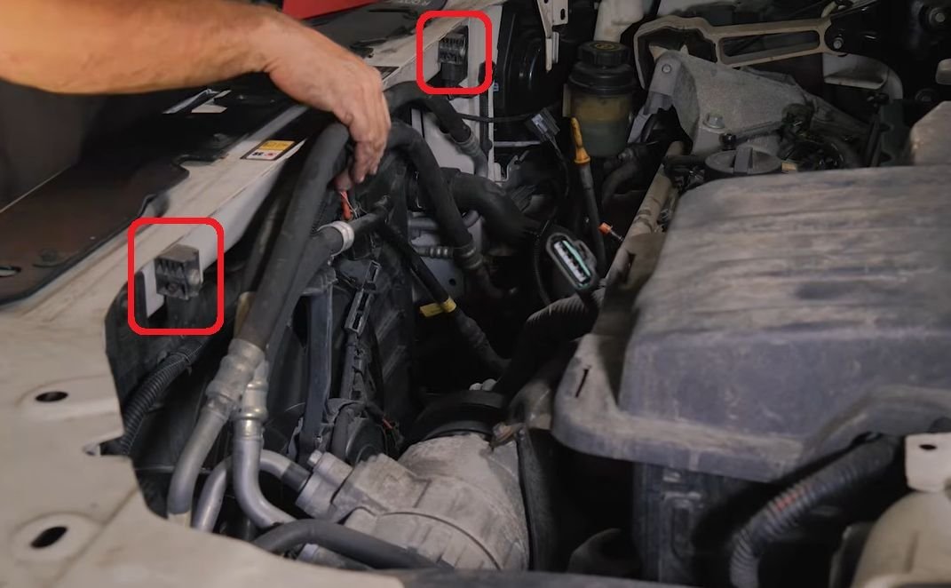

Does anyone know what these two components are? One side is all white. Appears to be some type of sensor.

OK, found it. They are part of the front crash/airbag sensing system – specifically the front impact (crash) sensors mounted to the radiator support. Each one has a wiring connector to send impact data to the SRS/airbag control module. Ford part # 3M5T‑14B342‑AB.
Mystery solved.
