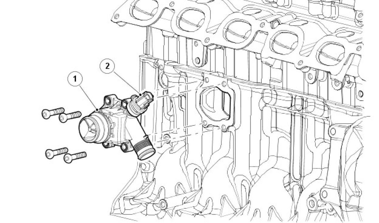

Was driving my 08 lr2 out of no where the temp gage said overheating then jumped back to normal over and over again I'm not leaking coolant and the engine isn't over heating. Any one have some advice for me?

Make sure the connector to the coolant temperature sensor (top right of the thermostat, #2 in the diagram below) is secure and the wiring is not damaged. If the connector and wiring looks ok you may need to replace the sensor. If you do that, replace the thermostat while you're at it, and check to see if the coolant hoses need to be replaced as well. It takes some doing to get in there so you might as well check/replace those things while you've got access.
