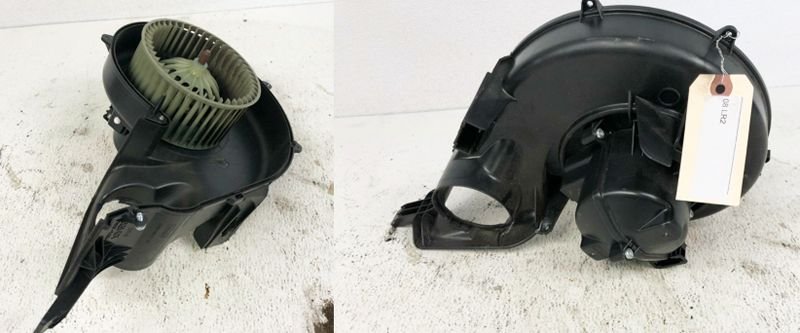

The picture is deceiving (I drilled the hole with the blower installed).
I only removed the wipers and the plastic cowl that is under the wipers.
Two 15 mm bolts and I used a small puller but you could likely remove by hand if you prefer.
Then about 6 plastic rivets.
To get to this point takes about 10 minutes.
Then you need to get out the drill.
Note: if you try to do this from inside the cabin you are correct you will need to remove a lot and you may as well just replace the blower.

For reference, using these photos of both sides of the blower motor, did you spray the grease into the closed housing behind the hamster wheel shown near the tag?
