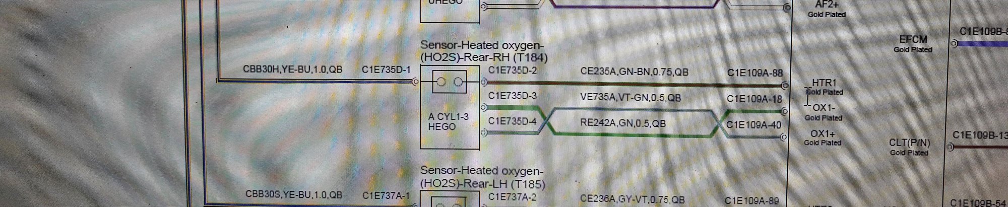

Looking at the two codes you mentioned, I would first fix p0037 ( bank 1 sensor 2 low heater circuit ) , since its either a downstream O2 sensor or a wiring issue , check the wiring for the heater circuit and if it checks out replace the O2 sensor Bank 1 sensor 2 and see how it goes , if you wanna avoid the wiring check swap the downstream bank 1 and bank 2 sensors , if the fault switches to bank 2 then you have a faulty sensor.
Old Mar 30, 2023 | 12:50 PM

Here is the wiring for bank 1 sensor 2
