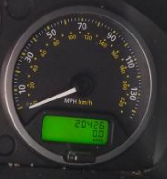

I dont think it is possible. Like the LR3, the milage is stored in several places. When installing a new cluster, for example, it will sync to what is in the system or if the cluster is used and has a higher milage, that. Basically it is pretty hard unless one wants to go with higher milage for some reason.
Probably no way to tell if it was hacked. It can be done on some cars, with specific programming skills and a hardware connection to the PCB for the instrument cluster. Common problem on some Hondas.
But on cars that take the higher of multiple records in different systems, it would seem impractical to get to all of them. If they really wanted to, it would be possible to build a chip with a physically irreversible counter... microscopic fuses that the chip burns out at 1,000 or maybe 10,000 mile intervals.
If in doubt maybe do a compression check, an excessively high mileage car probably won't have great numbers.

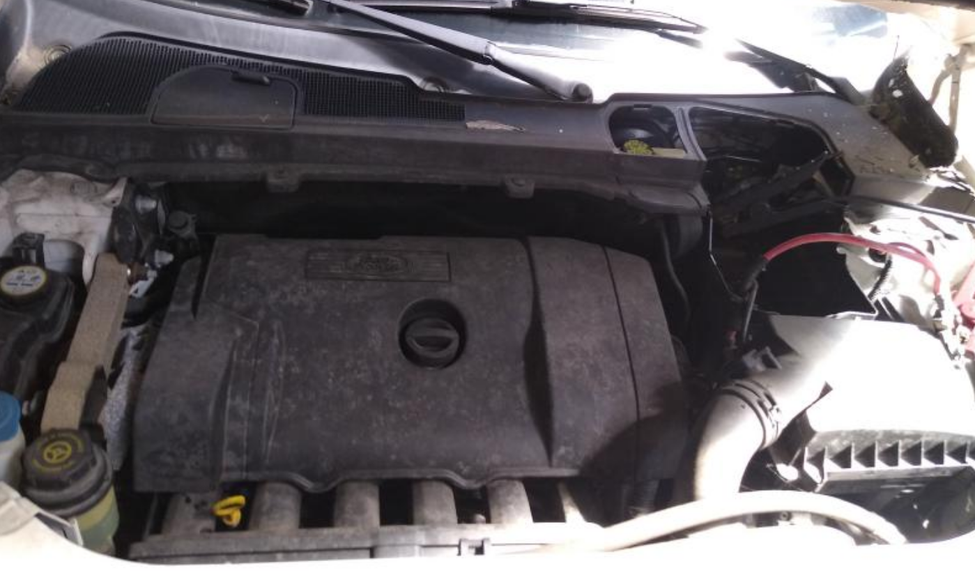

This one pegs my bullsh*t-o-meter off the scale, and I have my doubts if I should buy it.

Well it could look that dirty under the hood after all those years and still be low time.
Personally I'd only do it if I could do a compression check and borescope (you can get cheap scopes that connect to your phone). I think I could tell the difference between a 20K cylinder and 200K cylinder. Or maybe the car sat for ten years without being started, that would be bad too but you'd probably see corrosion inside.
Obviously you don't know if the engine is from the same car as the odometer pic, unless you can get the guy to do a video walkaround.
Of if the owner is in a smog state and has regular records of smog checks over the years, with mileage. Of if it was dealer serviced and he has those records (or can get them from the dealer). Such records would show mileage and also mileage trends over the years. Also ask for an explanation, granny drove it two miles to church every Sunday is better than sat in the barn without being started for a decade.
I bought a boat a couple years ago. In the 20-30 year old range, there's a sweet spot for hours on the (diesel) engines. You obviously don't want 10K hours, but if it only has 300 hours then it obviously spent a lot of time non-op doing water-front condo duty at some in it's life. Sweet spot is maybe 1K-3K.
For a (gasoline) car, I'd probably want 3K/year as a minimum without having concerns about too much non-op time. Apparently all the fraudsters who misrepresent the miles on worn out motors and trannys typically advertise around 60K... low enough to have plenty of life left, but high enough to sound plausible. The fact that guy is advertising 20K actually might work in his favor.

I'm going to pass on that 20k engine. I'm getting bad vibes from not knowing how well it was taken care of when it was not being driven.
