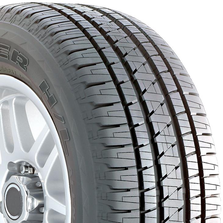

Default Summer tyres are Bridgestone H/L.
My summer tyres are Bridgestone H/L on my 19" rims in the stock 255 55 R19 XL size. They actually have a M+S winter rating but that is probably due to the rubber rather than the tread design.
Up here, on pickups, a lot of guys install the A/T tread and run all year round with that. They are a practical alternative with regards to price, availability, and suitability.
