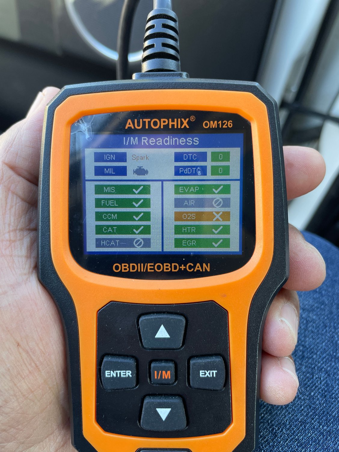

Hello all, this is my first post on this LR3 forum.
I am trying to purchase 2008 LR3 SE with 164000 miles. During my inspection I found few things that I can do DIY. But I found that during my OBII scan, that IM ready is NOT ready for smog check in California, it is showing O2S is not ready. Please note that there is not DTC pending or current. So No Codes. Or NO Check Engine light.
See photos. Is any one know how I can clear this O2S ready so I can purchase 2008 LR3 SE and get smog check.

Looks like they were recently replaced and you just need more driving time.
Basically in any car monitors like that need a certain number of driving cycles to reset. (start, warm up, 20 min driving minimum preferably highway, cool down)

It could also mean they just recently reset the engine light before you came to look at it. The system needs more time/miles to activate. It prevents people from clearing engine codes just prior to DEQ/smog testing. So it could have some engine issues they're trying to mask by clearing codes before buyers see it.
Just a thought
