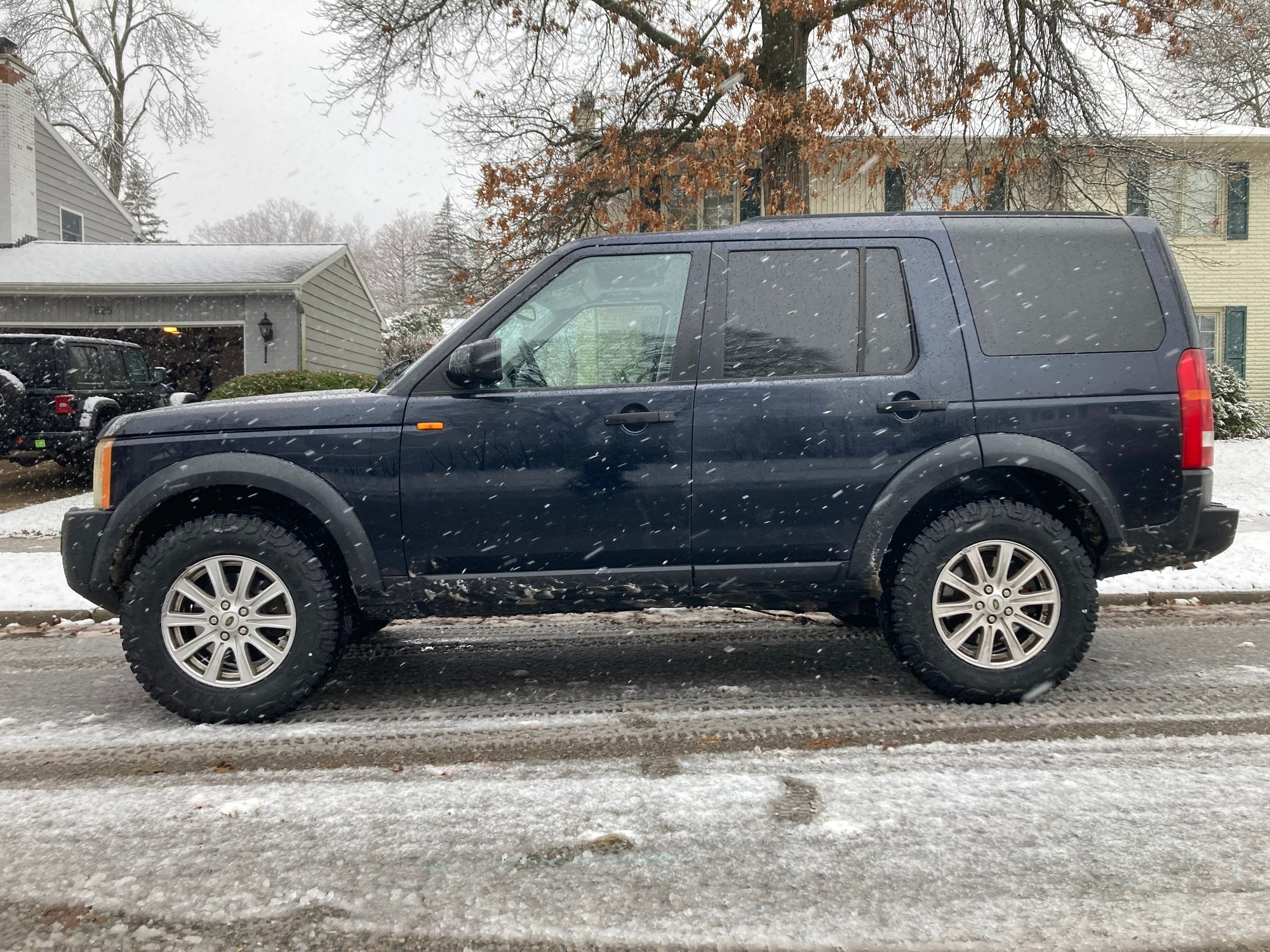

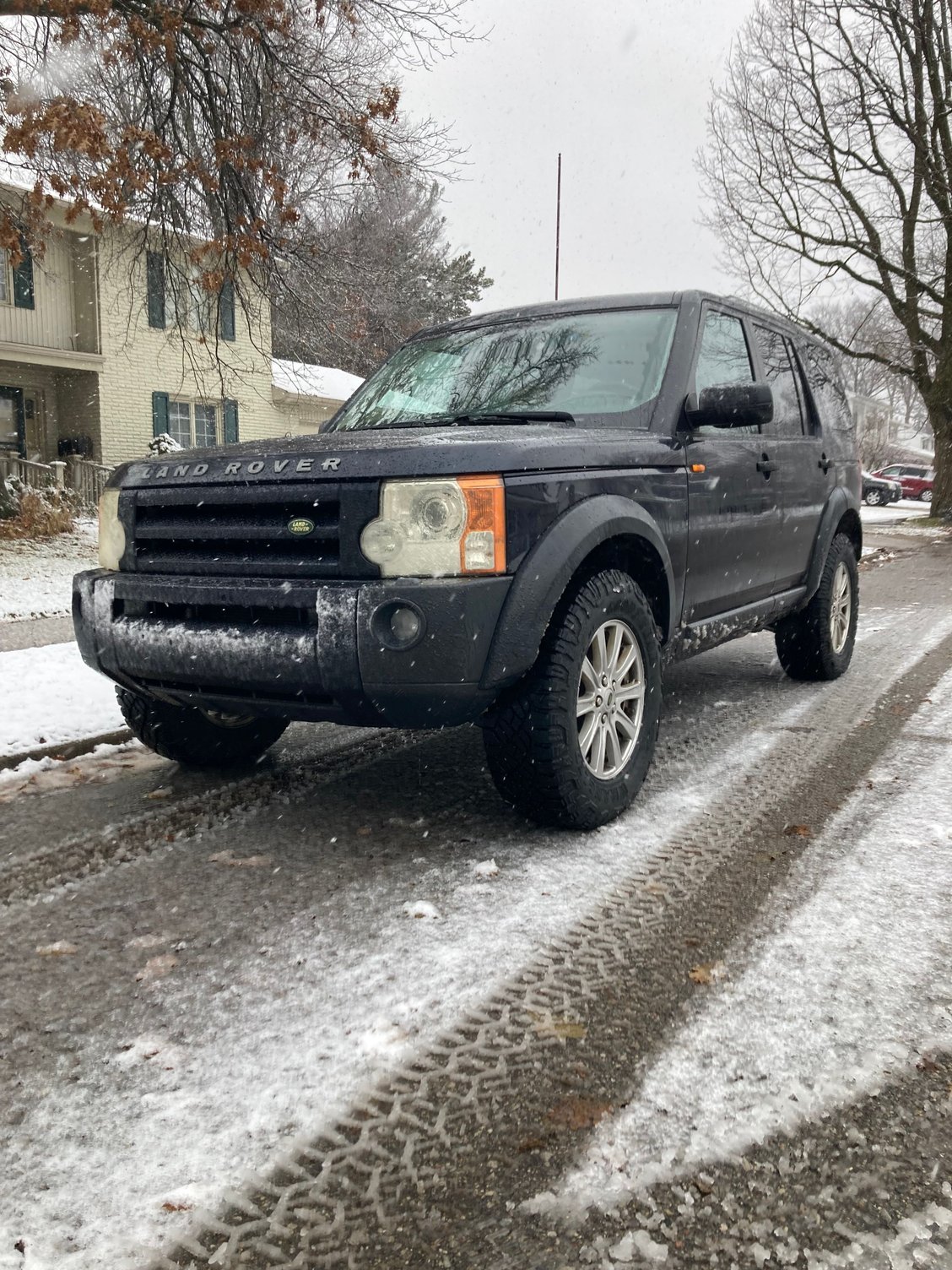

just got the Rover back from Belle Tire. They want the rear upper control arms replaced…must be a different technician. Turns out I’ll be cutting them off next weekend.
in the meantime, enjoy this beauty. Goodyear Duratracs 275/65/R18.

You can’t. The calibration applies to standard height only. That’s why the system goes offline when doing it. Does not matter what the switch is set to. Looks good! I think with larger toes and some lift the wheel wells just fill up better. Stock size is too small.

So, has anybody else thought that maybe LR could have centered the rear wheels a bit better in the wheel wells? I have looked at mine and thought it needed to be about an inch or two back. It's just a bot off.
Old Jan 1, 2025 | 11:18 AM
DakotaTravler's Avatar
Joined: Nov 2017
Posts: 5,084
Likes: 981
From: Green Bay, WI
If that is the case, you may have worn bushings or need an alignment. During articulation they do move reward a little but at normal height they should not look too far off center in the wells. Do you have a nice side profile photo you can post?
