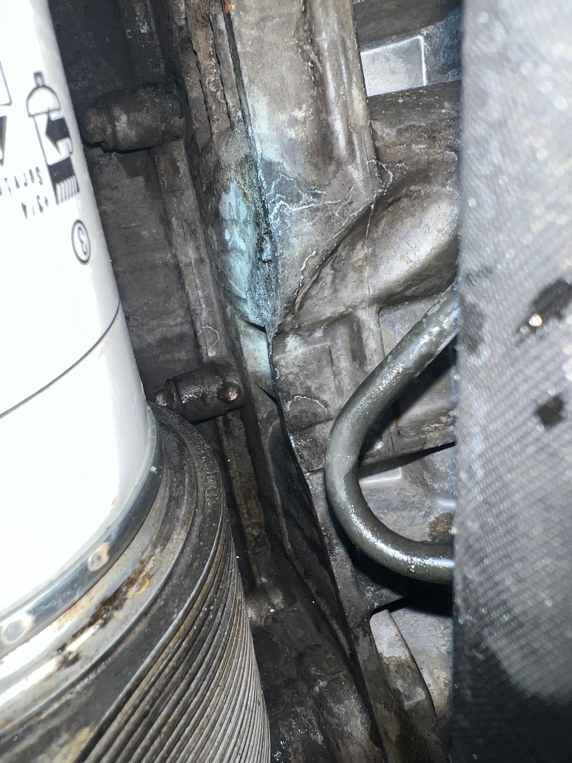

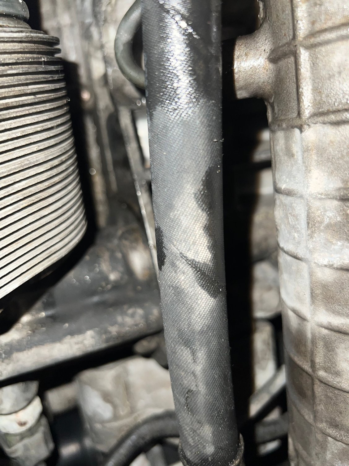

Hi Gang - I'm posting alot, because I'm trying to do a lot. I just finished out the radiator flush yesterday. Put lift rods on today, and have been driving it around for at least the past week. Take her out tonight after the rods, and then notice coolant on the garage floor. Small puddle. The leak appears to be on the front of the engine, and then dripping below. I don't see anything up top around the thermostat housing, but I only removed the cover and used a flashlight. This is a slow drip while the car is running. My guess is a water pump replacement is in my future?

If you can't readily find the leak you can use a UV dye and black light you help. But chances are once you're a little deeper in there you'll see it.

Definitely the water pump. I'd say the replacement difficulty was 3 or 4 out of 10. Not too bad at all.
