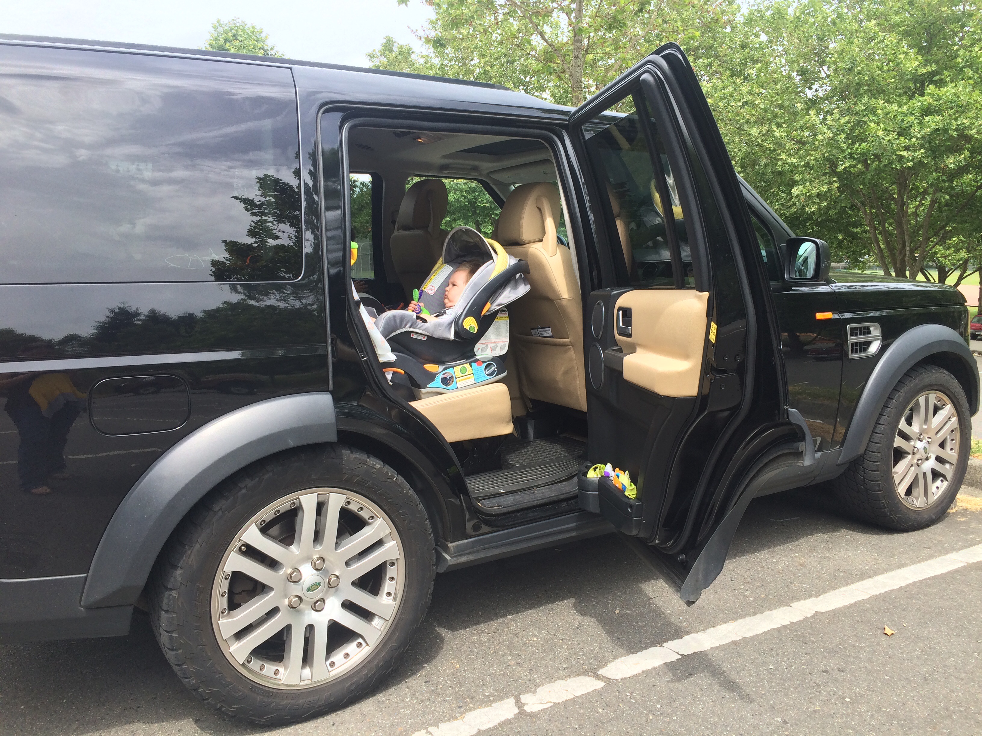

Geez....not too sure without more info. Could be a calibration issue or a failing compressor.
