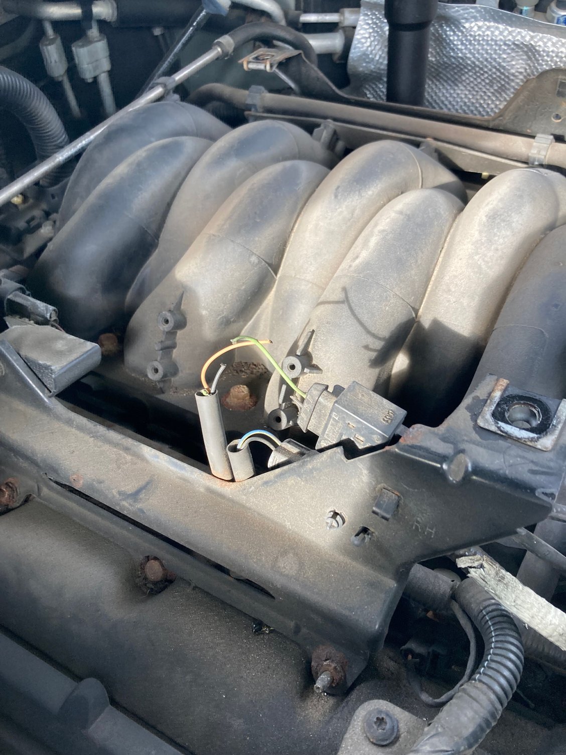

Alternator is dead…car shut off with the dash lit up like a Christmas tree. Jumped it and wouldn’t stay running without the jumper cables. The jumper cables were
very warm when taking them off the battery. While investigating, saw these wires were brittle and broken. Assume these are fuel injector wires? The vehicle ran smoothly and mileage was great prior to alternator dying. Thoughts on these wires?

looks like mouse chews

I cannot recall what those wires are, I would make two short jumpers twist tie them together and test start it.
Do you have any DTC codes that you can share with us to help us further your diagnostic quest?

does anyone know what wires these are for in the pic I attached in the original post?

They’re wires going to the engine knock detonator sensor plug… I think. The connector looks correct but you’re supposed to have four wires (two per sensor).
Ideally you’d would want to fix the wiring or replace the whole thing but it’s not exactly cheap, the complete thing is part
4603186.

There are 4 wires, just can’t see them. They have broken at the plug and wire harness wrap. There are a total of 4 plugs on top of engine - 1 at each side front and back. This is on the passenger front side of the engine.
