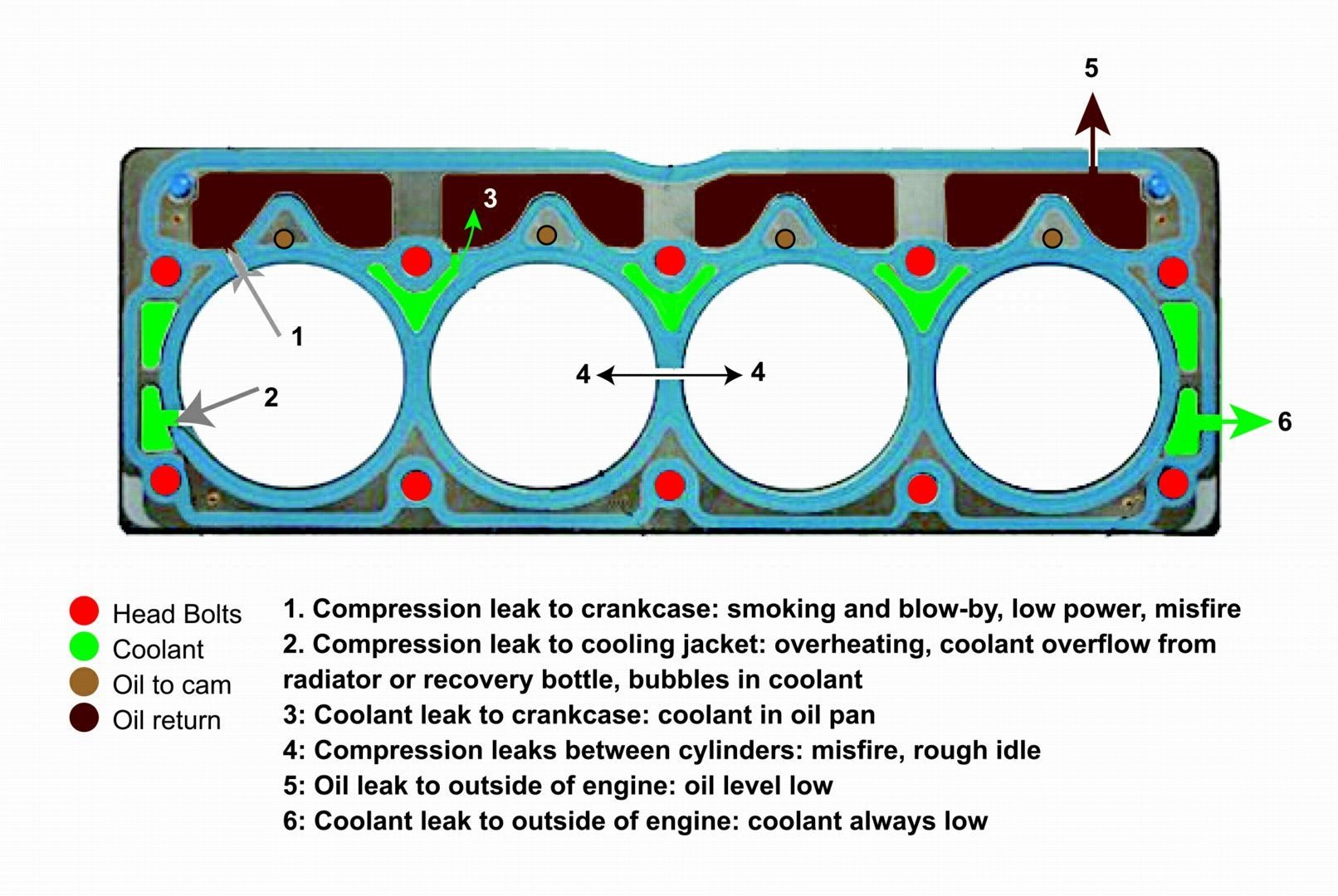

The head gasket can fail in a number of different ways:
