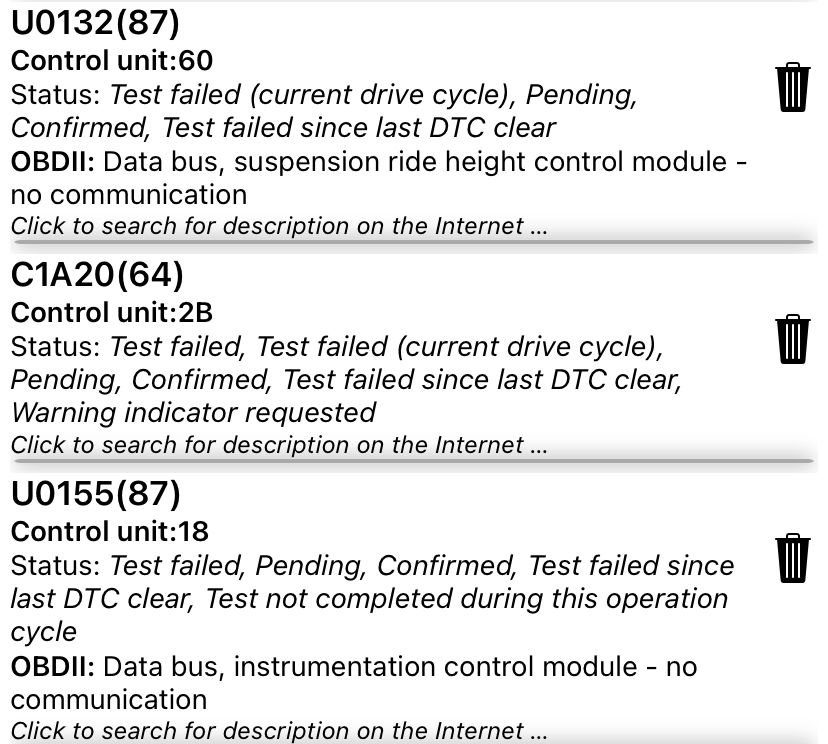

Old Oct 31, 2022 | 06:16 PM
Jekyllman's Avatar
Joined: Nov 2020
Posts: 46
Originally Posted by tracyc
You'll need to post codes to start to get a diagnosis, but if you abraded any wires that could of course cause issues.
Heres the ones coming up. You can see the C1A20 is the one that requested the light.
