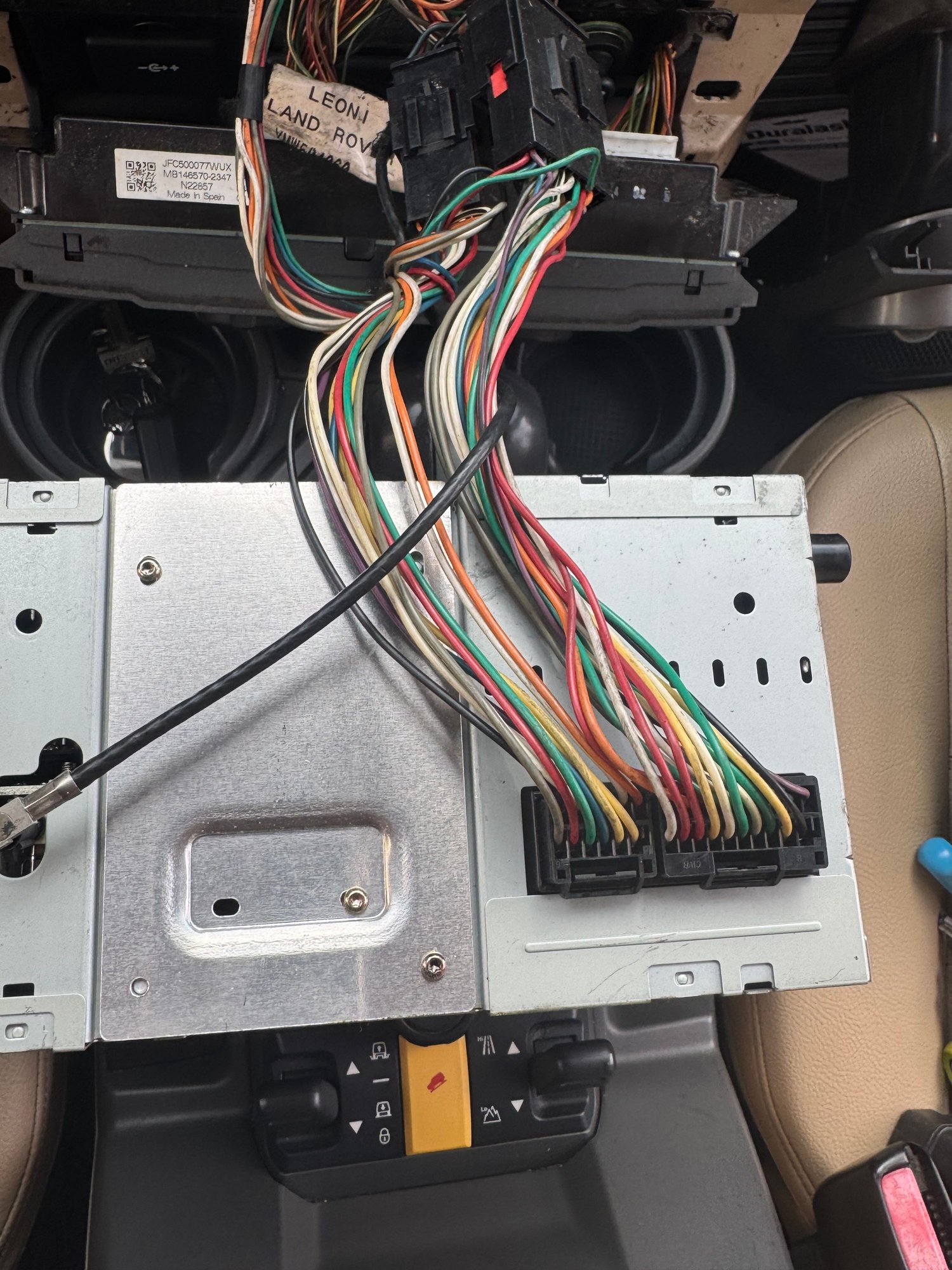

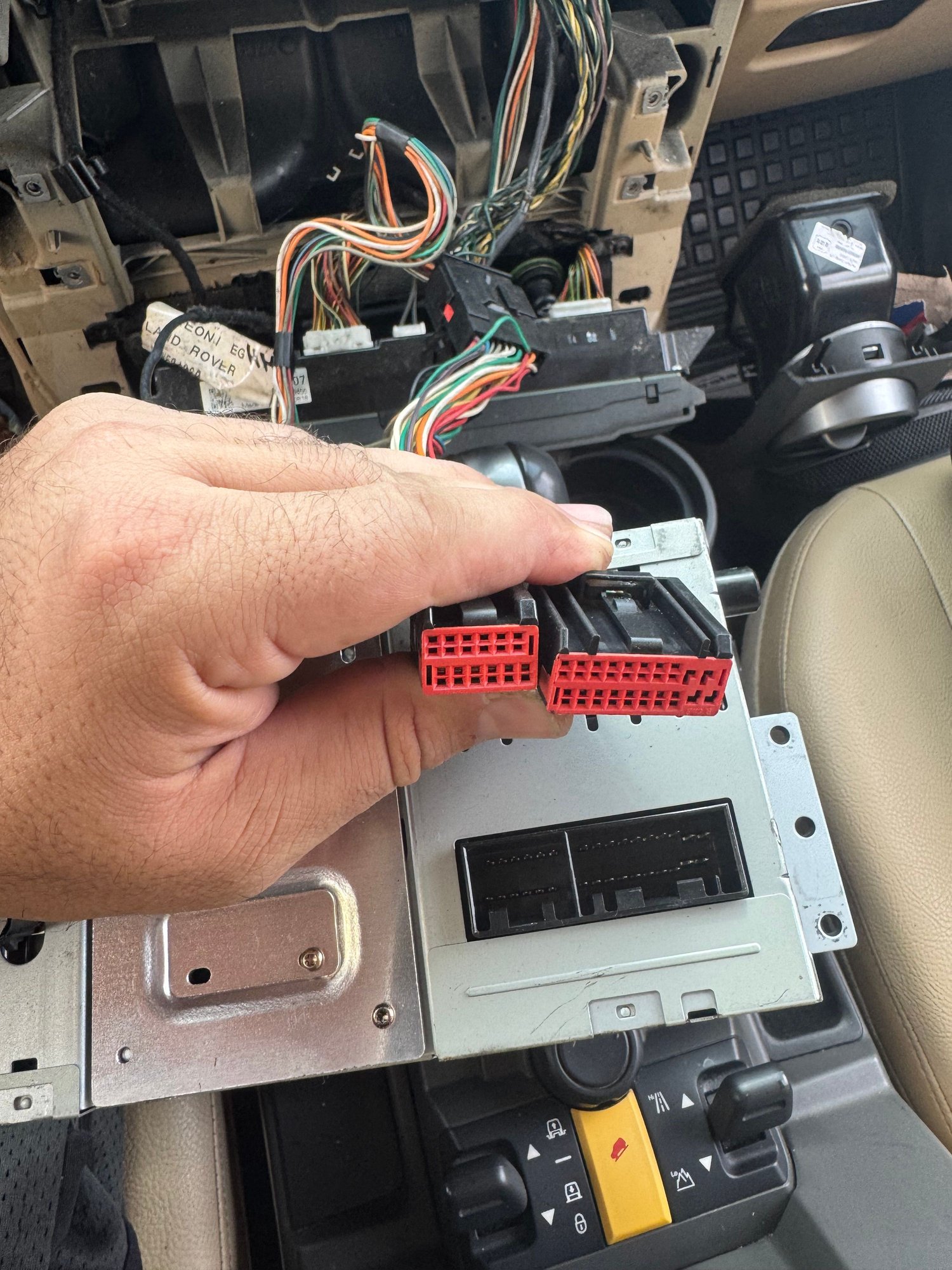

In the CD400, what is each side OEM Wiring? 12 vs 16+4 cables. Looks like the aftermarket wiring is just for the 16+4, I assume that’s power and speakers.
Old Jul 6, 2024 | 07:05 PM
loanrangie's Avatar
Posts: 1,620
Likes: 266
From: Melbourne, Australia.
The smaller plug is superfluous, it has the aux input wiring in it.
