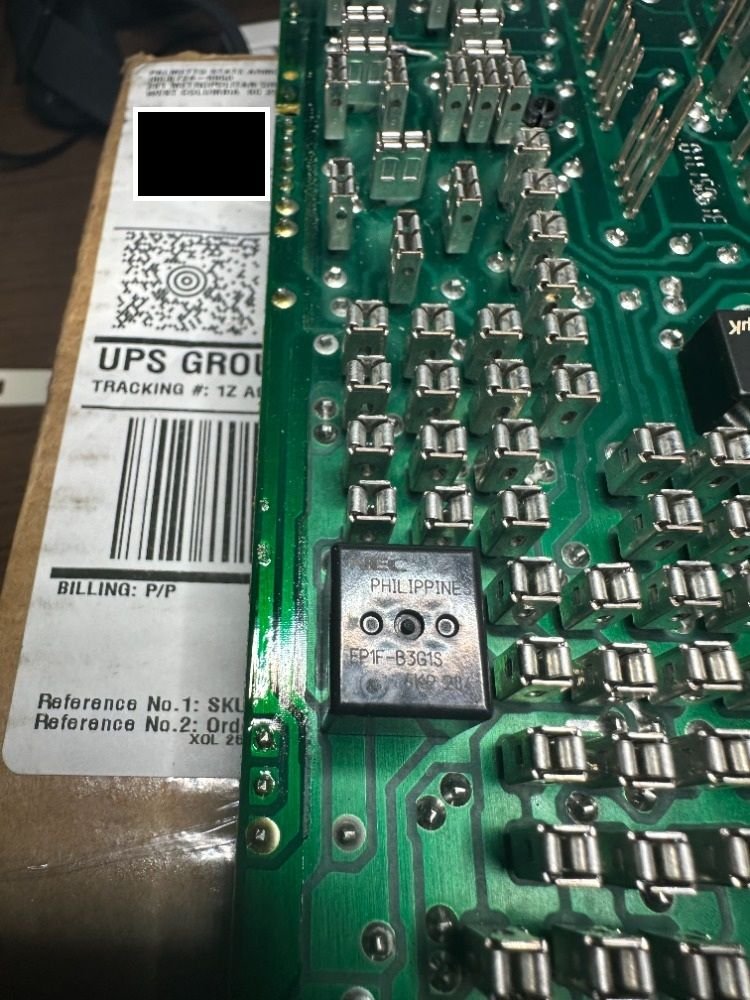

Well, got the CJB out and figured out how to take it apart. Not super hard. There are two boards with a standoff plate between the two boards. You have to take all fuses and relays out which holds the 2 boards in place. The two parts are soldered together in MANY places.
All of the fuses had some sort or corrosion on them and some were difficult to pull out. I opted not to take the two boards apart. I just drenched it all with some spray Deoxit D5 (even in between the two boards), let it set, then sprayed everything off with standard CRC electrical cleaner.
Just ordered all new Bussmann Fuses and the three relays.

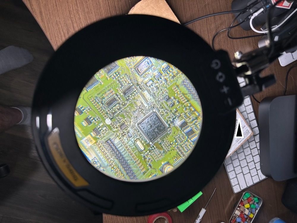

I would take a super close look for any cold (cracked) solder joints at connections, etc. Reflow as needed. I do not envy the work you are doing.

Didn't see any cold solder points under a magnifier, put a hard tool on every joint I could access without de-soldering the boards, and even told my wife (she's Filipina) that I might have found the issue
Without digging further, I have gone as far as I can. At this point, without replacing the CJB with a brand new one, I think the overall issue must be somewhere else. Next is the ECM.

Yes I did. Wasn't easy
Pry apart the case at these points
