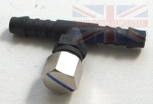

I almost think your coolant sensor is working. I say that as it seems that if it is not, the engine tends to just quit or really act in a miserable manner.
I recall a few years back where a mouse had eaten the wiring going to the sensor and as it is located under that black plastic engine "sound" shield, mouse feasts are not that obvious.
And yes, if you are going to change the sensor, per the post above, take the opportunity to change out the whole assembly. You get a new sensor, a new thermostat and most importantly, all new plastic.
Additionally, the thermostat is probably put in correctly - not that easy a task. Pour in all new coolant as well and you will be set for a couple of years.
Change out the bleeder tee also hidden under the sound cover, part number LR027661, while you are doing all that as that tee is usually the first cooling system plastic to fail.
Attached Thumbnails Coolant Temp Sensor-bleeder-tee-lr027661.jpg   Coolant Temp Sensor-thermostat-housing-complete-lr005631.jpg
