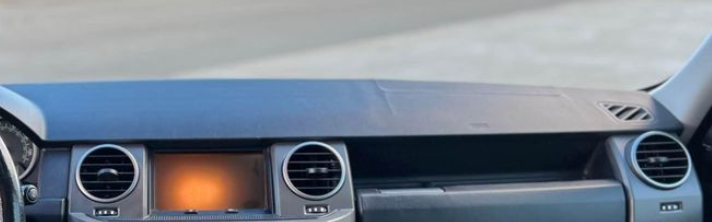

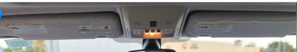

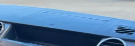

Hello All, Am considering buying a used 2006 LR3 and need your (expert) opinions about reason/possible risks to check for in this vehicle related to the Dash lining and Sun Visors puckering - IDK but may be water leaks from sun roof).

I wouldn't worry much about either.
The dash on these is 100% guaranteed to crack no matter how much you care for it. Same goes for the glue holding the felt to the visors. Especially if you're in an overly sunny/hot region like the south. If you want to look for evidence of water inside the cabin, look under the floor mats for any floorboard staining. Look at the headliner and a pillar covers for any staining.

That dash looks surprisingly good for its age, relative to most! I recently bought a 2007 that was well-kept but the dash cracked all over. A dash cover from coverlay fixed that quickly and fairly inexpensively, and looks almost as new.
