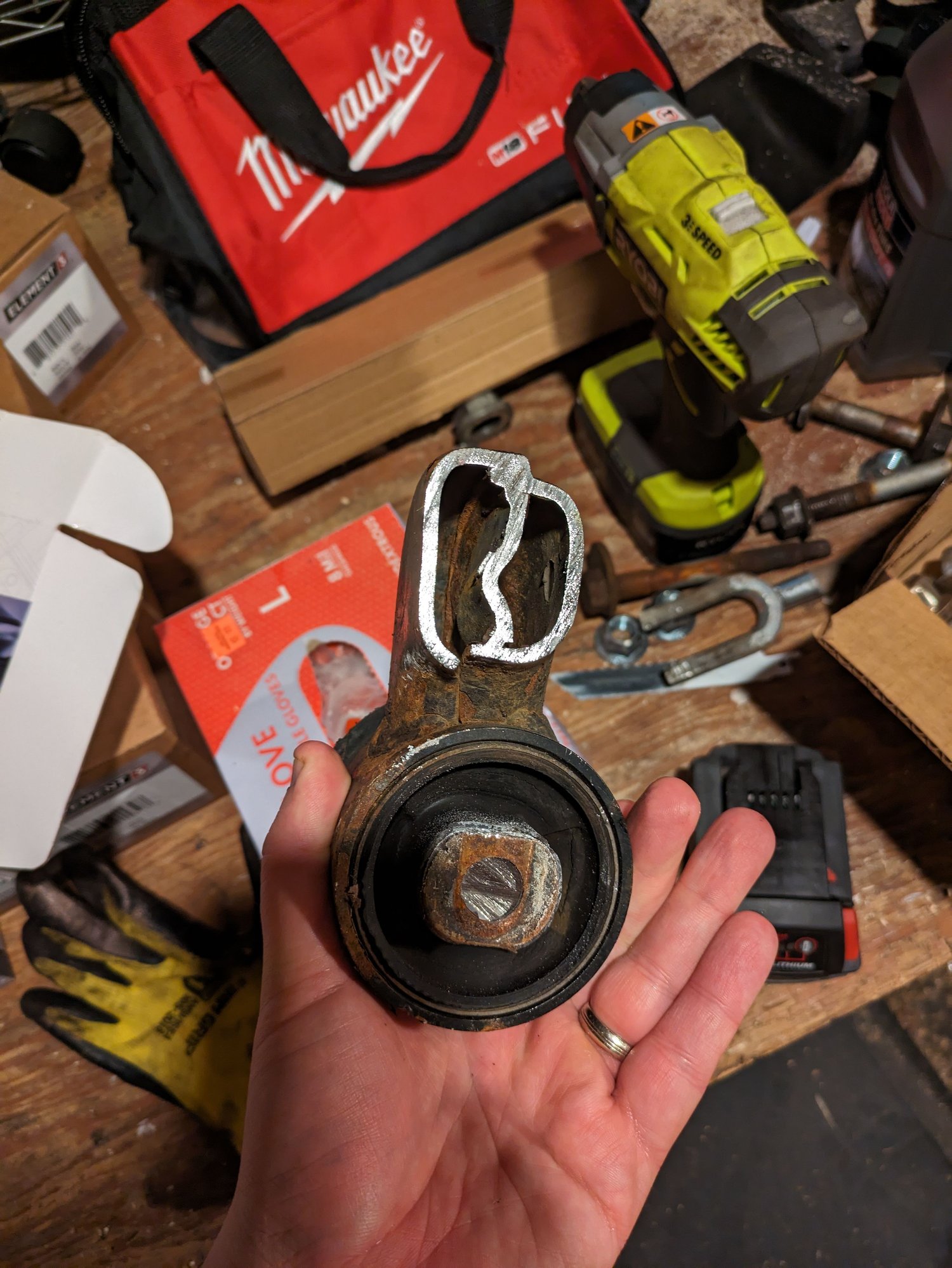

Well almost a year later I finally got to it. Wound up buying a Milwaukee impact which took three of the four bolts out, and the sawzall took the last one out. Better late than never I guess.
