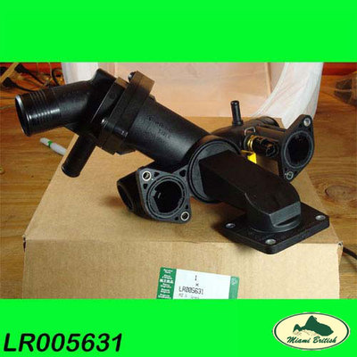

To my mind, the thermostat is not easy to change. The link below is a good one in that it shows the second try to get it right. It seems LR fixes always have a bit of a twist to them. Also getting the air bubbles out can turn the refilling process into a multi hour task and use the opportunity to pour in all new coolant.
How To: Replace your Thermostat
If you are looking for an easy way to change your thermostat, install as below the complete assembly, LR part number LR005631. It solves two problems, getting the thermostat install correct and also the plastic ages so new plastic solves the cracking problem that shows up with time. Also the cost of the assembly is only a few dollars more than a thermostat by itself and the install labour is less and easier.
Also replace the bleeder tee, LR027661, as it is first to crack.

Yeah I just made an appointment with my local mechanic to get it done professionally I have an '05 4.0 v6 and it looks like the ones you listed are for a v8? I bought one that's an upper/lower hose assembly that has a thermostat as well as it looks like that's what I need. I'm also getting the front air suspension filters/beads replaced as that just went as well!
