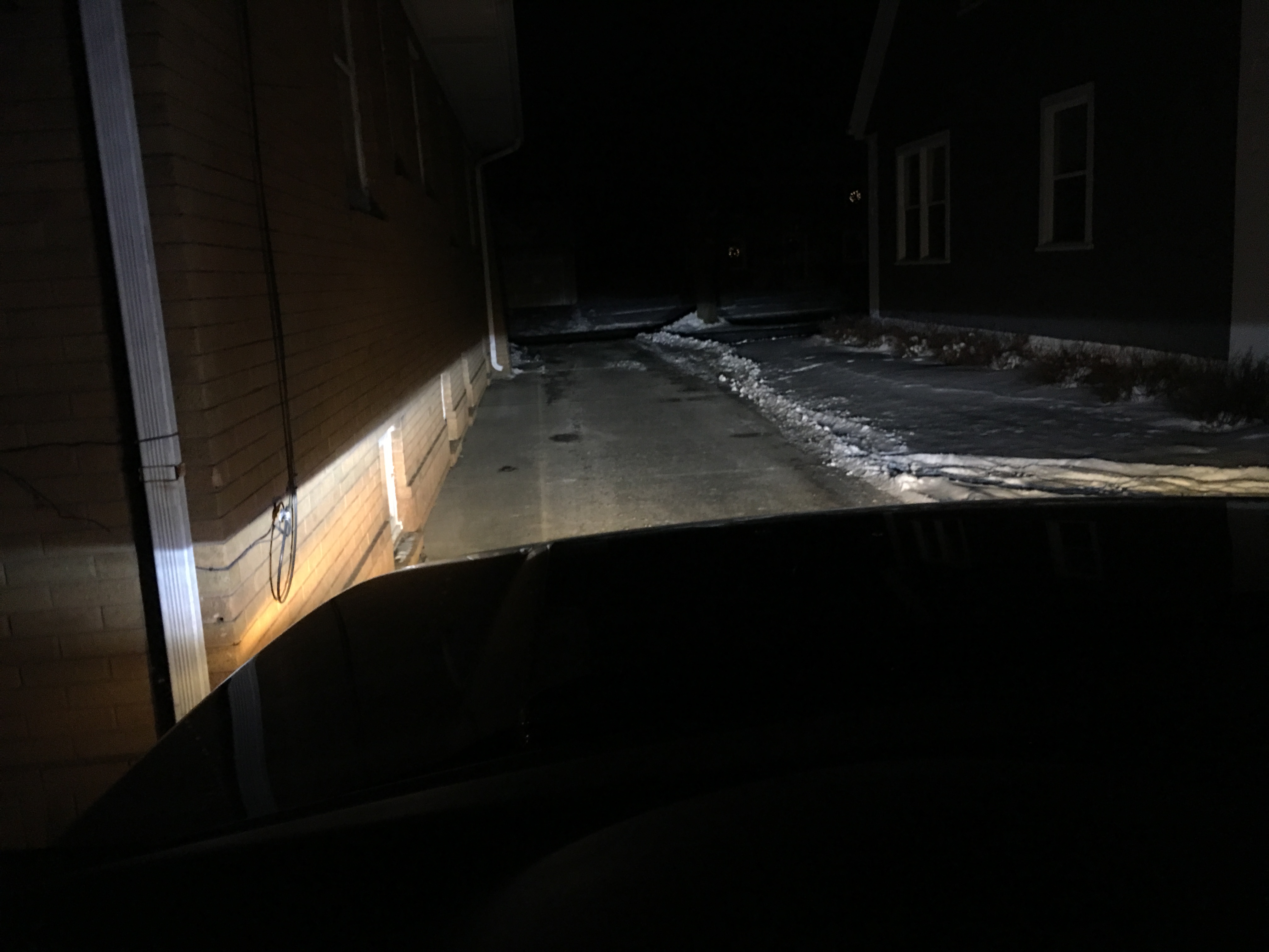

Interesting information. When I took the bulbs out to change them, the part number was the same as on the new Philips 4300k bulbs I ordered. But they were certainly much bluer. The new philips bulbs almost looked like standard halogens to me.
However, I do agree that 6000K might be too blue and light output would suffer traditionally.
I ended up ordering a set of the OSRAM CBI 5000K bulbs, and was very pleased with them. Although the name is "Cool Blue Intense," there really isn't any blue that I can see. The light color is a very cold, pure white. They put out 3400 lumens, compared to the 3200 lumens of the OEM philips bulb - and they do it at a higher kelvin temperate (i.e. a more pure white in this case compared to the yellowish light of the philips bulbs).
Amazon Amazon
Overall very pleased and would recommend.
Note that OSRAM just released an updated version of this bulb that runs at 6000K, but again with no loss in lumens output compared to the 4300K and 5000K bulb. However, they are about $180/2 bulbs now compared to the $110 I paid for the 5000K ones and I didn't see the need to spend $70 more just for more "blue" and the same lumens.
Side note: bbyer, I also have the PIAA 2500K bulbs for fogs - they really are the best when the snow or rain is coming down hard (or... when it's foggy!). I adjusted them to aim upwards just a bit so that, if the weather is really bad, I can run with just those on and the HIDs turned off. Another highly recommended lighting upgrade.

Incidentally, I noted the snow in your very good jpg re the above post, and the flat cutoff.
You might post one with just your yellow fog lights - that is a good location for showing off bulb illumination.
Yes, I've read that before about the Daytime Running Lights configuration. Is that a legal requirement for all of Canada or only certain provinces? It's really a shame that leaving the Xenons on all the time is the best solution LR could come up with to meet that requirement. I'm assuming with the newer LR4s, the LEDs serve as the DRLs instead of having the Xenons on all the time. That would annoy me for heavy snow/rain situations as you said, as well as just the annoyance of going through expensive Xenon bulbs more often. To my knowledge, no states in the US require DRLs. I know Illinois does not.
From what I understand, the 5000K bulbs I purchased were developed and released around 2013. I don't understand the chemistry/engineering behind it, but they claim there were advances in technology that allowed for the higher lumens output along with the higher K. Perhaps a different combination of gases in the bulb. So I would agree that the 4300K Philips bulbs, once industry standard, are now a bit outdated just based on my own non-scientific comparison here.
And thanks, that picture was just taken quickly in my driveway. The only thing it doesn't capture well is that the beam pattern now seems wider with these bulbs than before. I might find an empty parking lot tonight to try and show that.

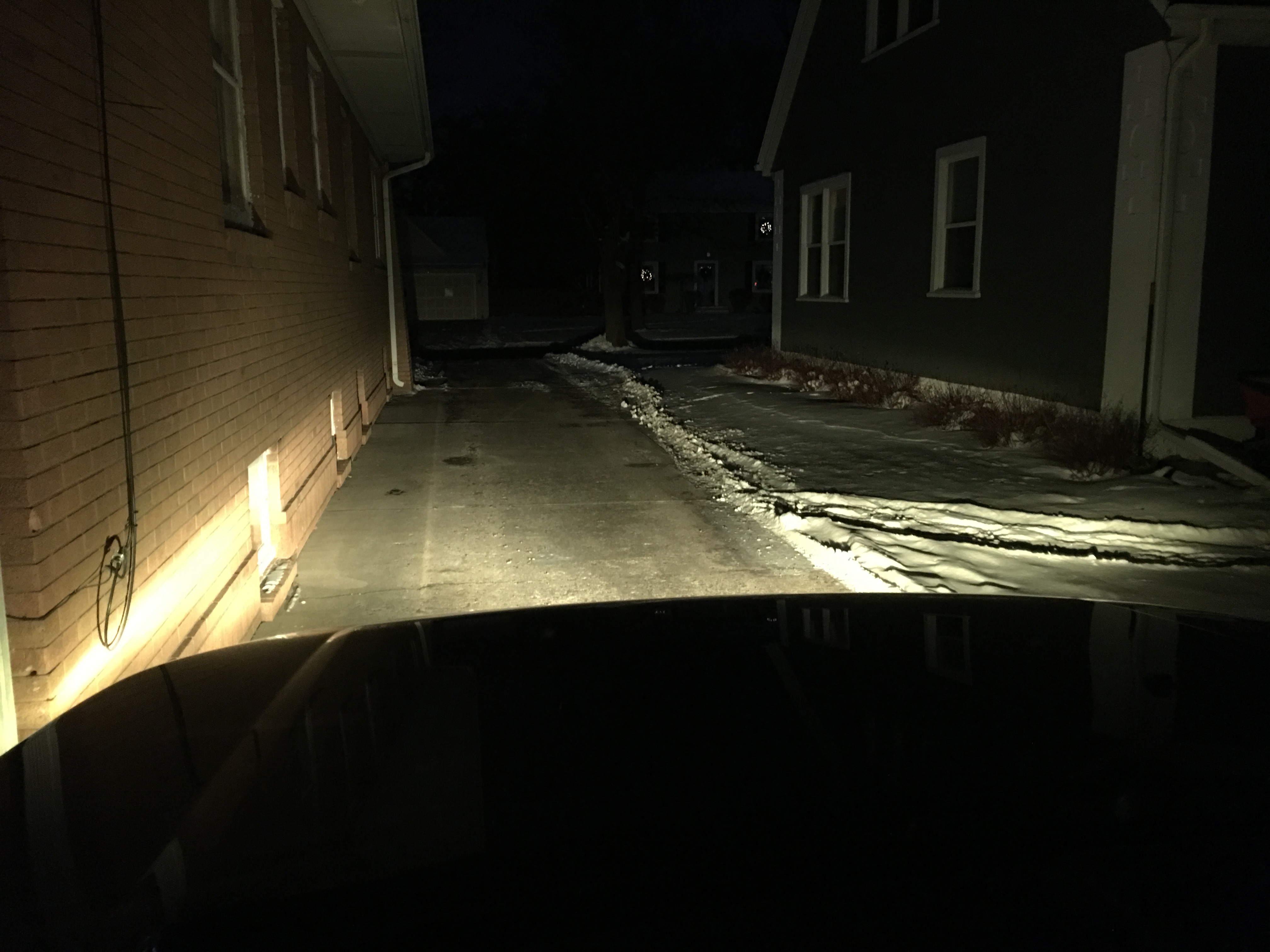

I will also take a picture in the same driveway location with just the fogs on as a comparison tonight.

Re your picture location, what one does see is the nice flat cutoff of our headlight focusing projectors - with the internal Fresnel etching, they are real class units and why they cost so much.
Good point about seeing traffic a ways off - I suppose you may have more inclement/extreme weather there where headlights really should be on all the time.
Agreed about the cutoff - it is striking to see all alongside the house.
I took a few more photos as I mentioned earlier. Unfortunately, my iPhone's camera didn't pick up the true color of the 2500K fog bulbs very well. They are much more yellow in person - I would say almost like the yellow in a traffic signal. The closest I could get to capturing the true color is if you look on the cut-off line on the house in the third photo, you can see it just in the beginning.
The first photo is just the fog lights on. Second is a view facing the truck, again with just the fogs on. Third photo is with fogs and Xenons on, low-beam (the lights appear dim here as the camera was focused on the house to capture the cut-off of the fogs/low beams more in focus). The last photo is with the high beams on. Here you can really see the benefits of the bi-xenon setup, as the clean cut-off line is angled much higher. I have 6000K philips halogen bulbs in for the supplementary high-beams that I think I will change to a 5000K bulb from PIAA - still looking into this.
Attached Thumbnails Factory HID Bulbs - 4300K or 6000k?-img_1465.jpg   Factory HID Bulbs - 4300K or 6000k?-img_1467.jpg   Factory HID Bulbs - 4300K or 6000k?-img_1468.jpg   Factory HID Bulbs - 4300K or 6000k?-img_1471.jpg
