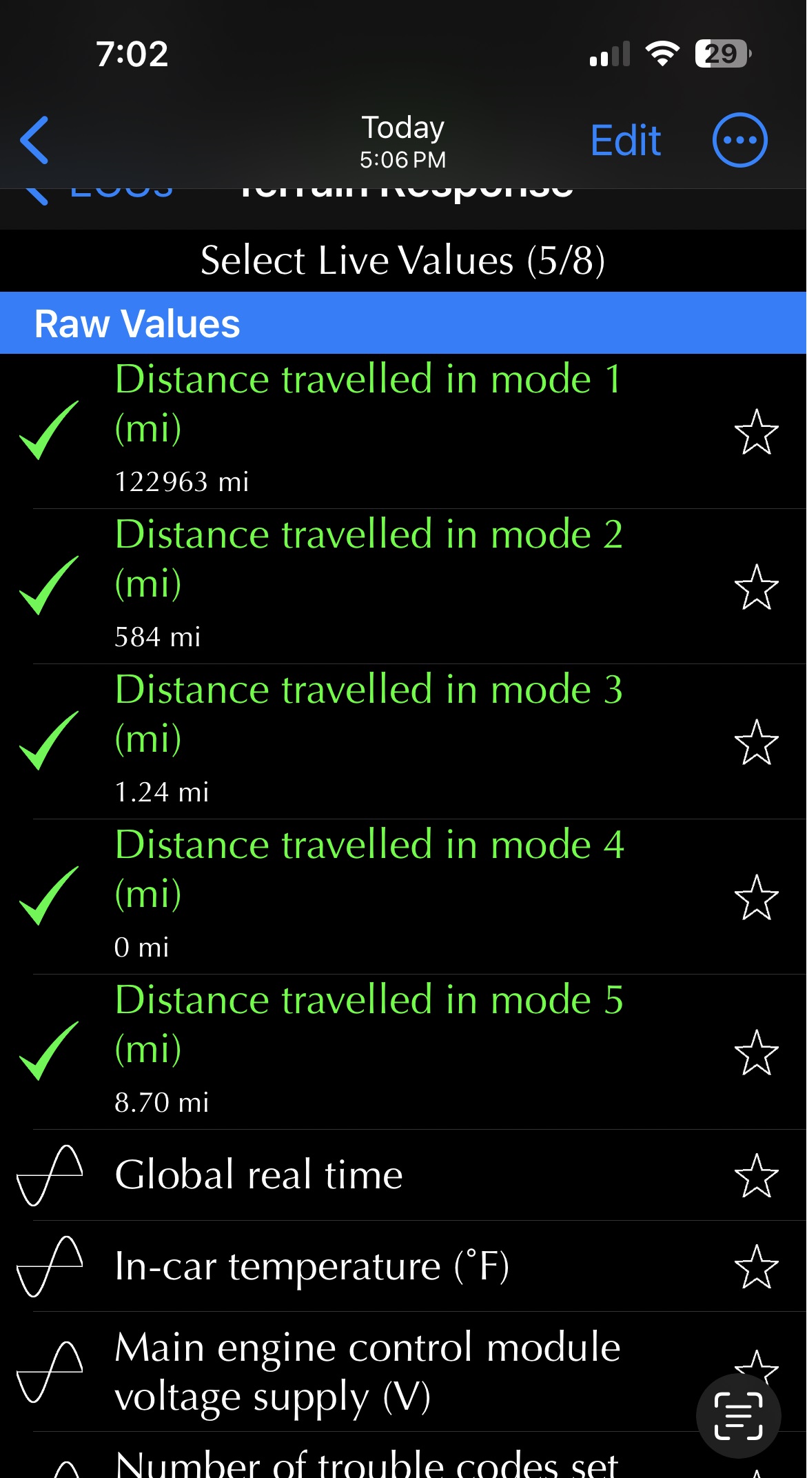

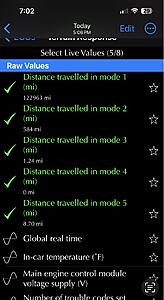

OK, that's not quite right above. It's under Live Values> Complete List>Terrain Response>Distance travelled in Mode 1-5
Mine has gone 600 miles out of 123,000 in a special terrain mode. Most of that has been me within the last 2000 miles as I bought a mall crawler....
