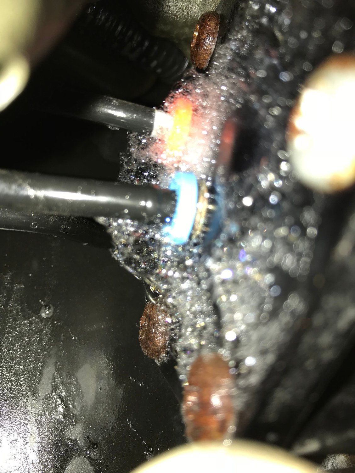

Originally Posted by thebruce
Thx! Yes, I would spray some soapy water on the dryer end cap and the larger air hoses on the other side while the compressor is running to see if you can spot any leaks. Prior to that my indy had already narrowed the problem down to the compressor based on the the fault codes he saw in the ECU. So I knew I was in the right area.
I opened the compressor case, started the engine and sprayed soapy water right at the dryer cap where the hoses go in. Foam appeared almost instantly. I will order up a compressor rebuild kit and dryer cap.
I'm very grateful for your post and the help it provided!
Awesome (well not awesome you have a broken compressor but im glad it helped!).
Im 2+ weeks in and working great after I installed the new metal dryer cap from X8R.
My recommendation would be to limit the variables to start with. Just replace the dryer desiccant since it will already be open, replace the end cap and inspect the o-rings for the air lines. Try that first. I created new problems during the rebuild so it was harder to isolate the problem.
You could even just try just replacing the end cap and not even take the compressor off the car. That would save you a couple hours and some bloody knuckles. You can probably get clearance with a stubby screw driver or right angled drill driver.
