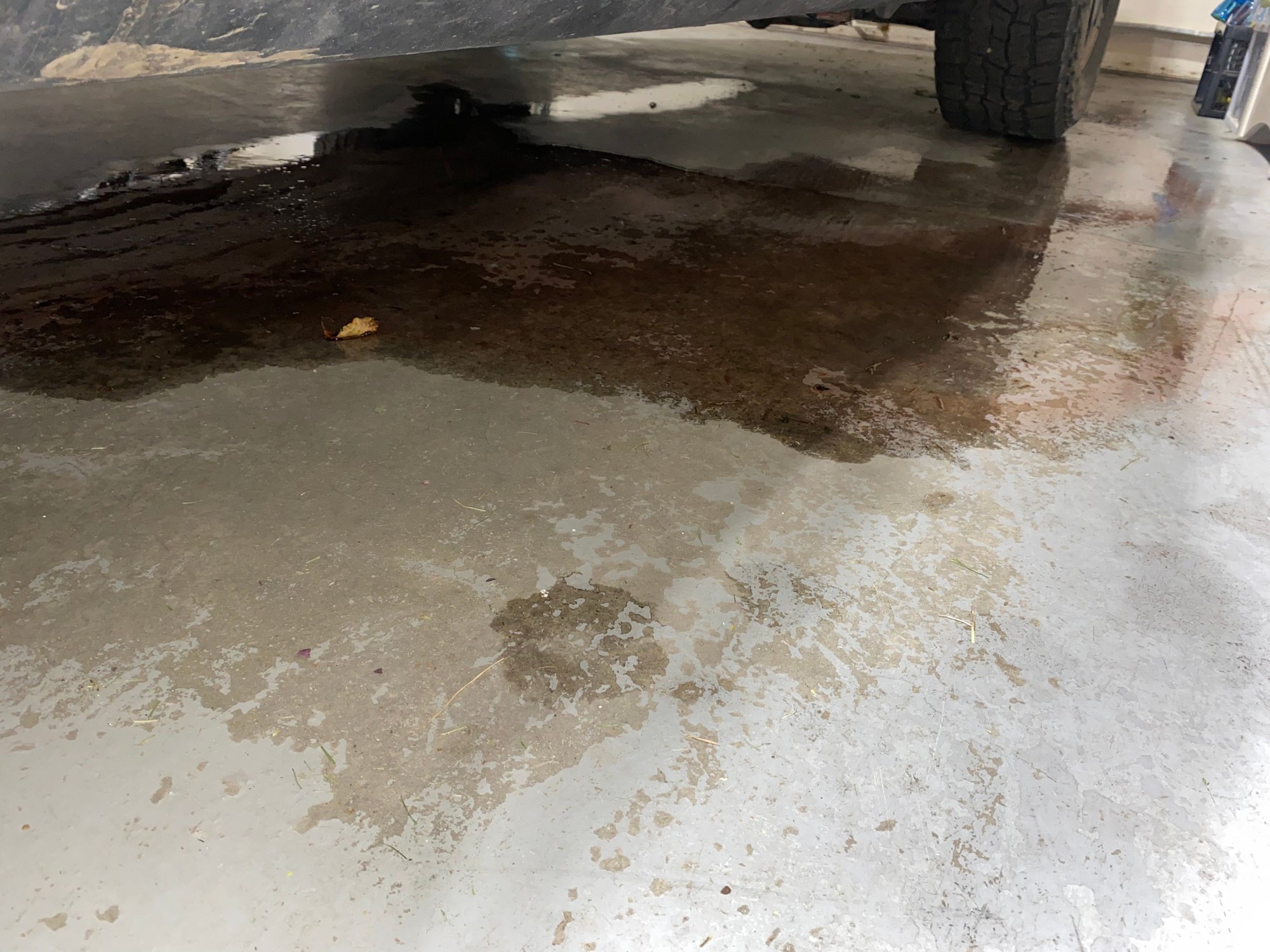

I just ran it for a while. No leak. Drove it around till the AT fluid got around 45 deg C. No leak. Put it into low range (didn’t drive) and no leak. Now I’m baffled. I’ll attach a photo of the stain on my driveway. Not sure how this happens and now I can’t replicate it.

Old Jun 14, 2022 | 10:23 PM
Jekyllman's Avatar
Joined: Nov 2020
Posts: 46
Alright I’m pretty sure this is the location on the leak. Just in front of the transmission pan. I’m attaching a photo of the leak drip point and one of the size of the puddle it’s created.
I’m not sure it’s related but the reason I didn’t drive it for a few days the first time this showed up was because my top coolant hose popped off and I lost a lot of coolant on my way home. I didn’t want to drive it without enough coolant. The couple days after that is when the puddle of transmission fluid first showed up.
