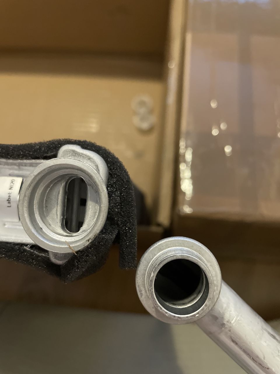

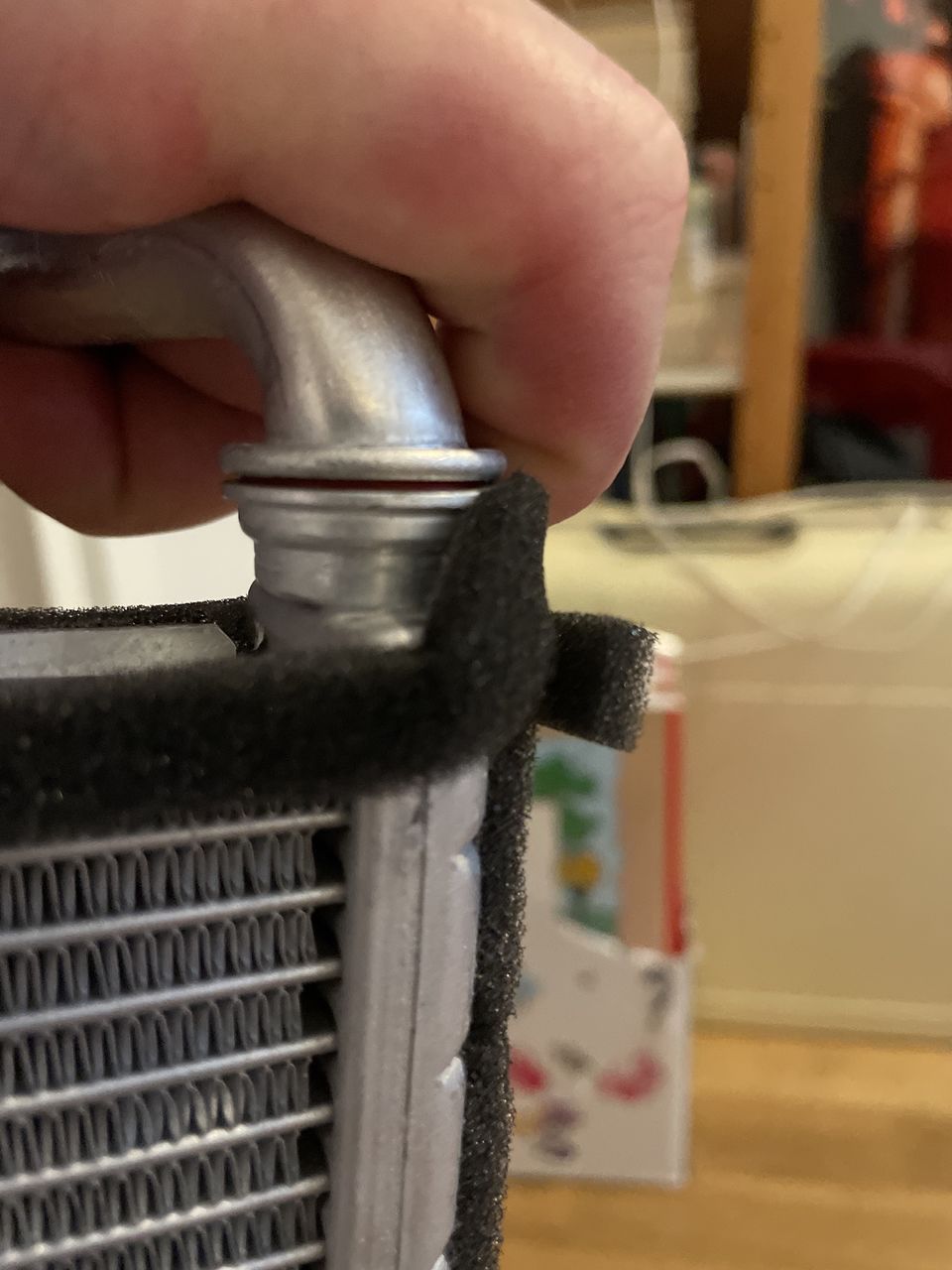

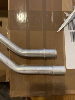

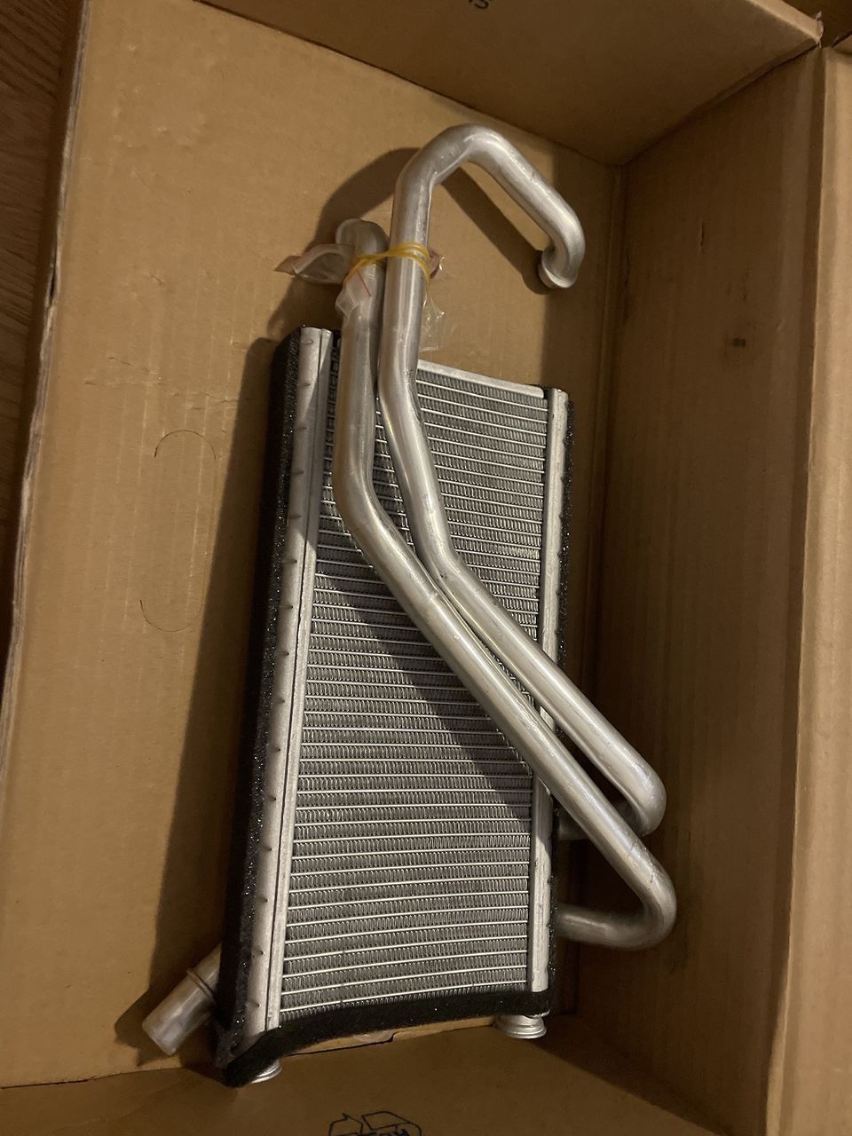

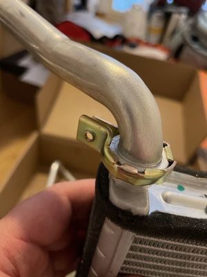

I can give a conditional “maybe” as an answer for you.
See, the thing is that originally the heater cores came in 3-4 parts: the core, the piping until the firewall, the O rings to the pipes and some kind of clamps. If you have an original heater core from 2005 (or so) you can remove the heater core and that’s that. No need to mess with the pipes.
Now, sometime later on (subsequent model years, I think applies to D4 mostly?) the heater core and the pipes started shipping as one integrated unit. I mean, the pipes to the firewall were welded on.
If you get a Nissens aftermarket heater core, the core and the pipes will be separate (see next post with images). You do not need to use the new pipes but instead the old ones will fit “perfectly” the stubs on the new core.

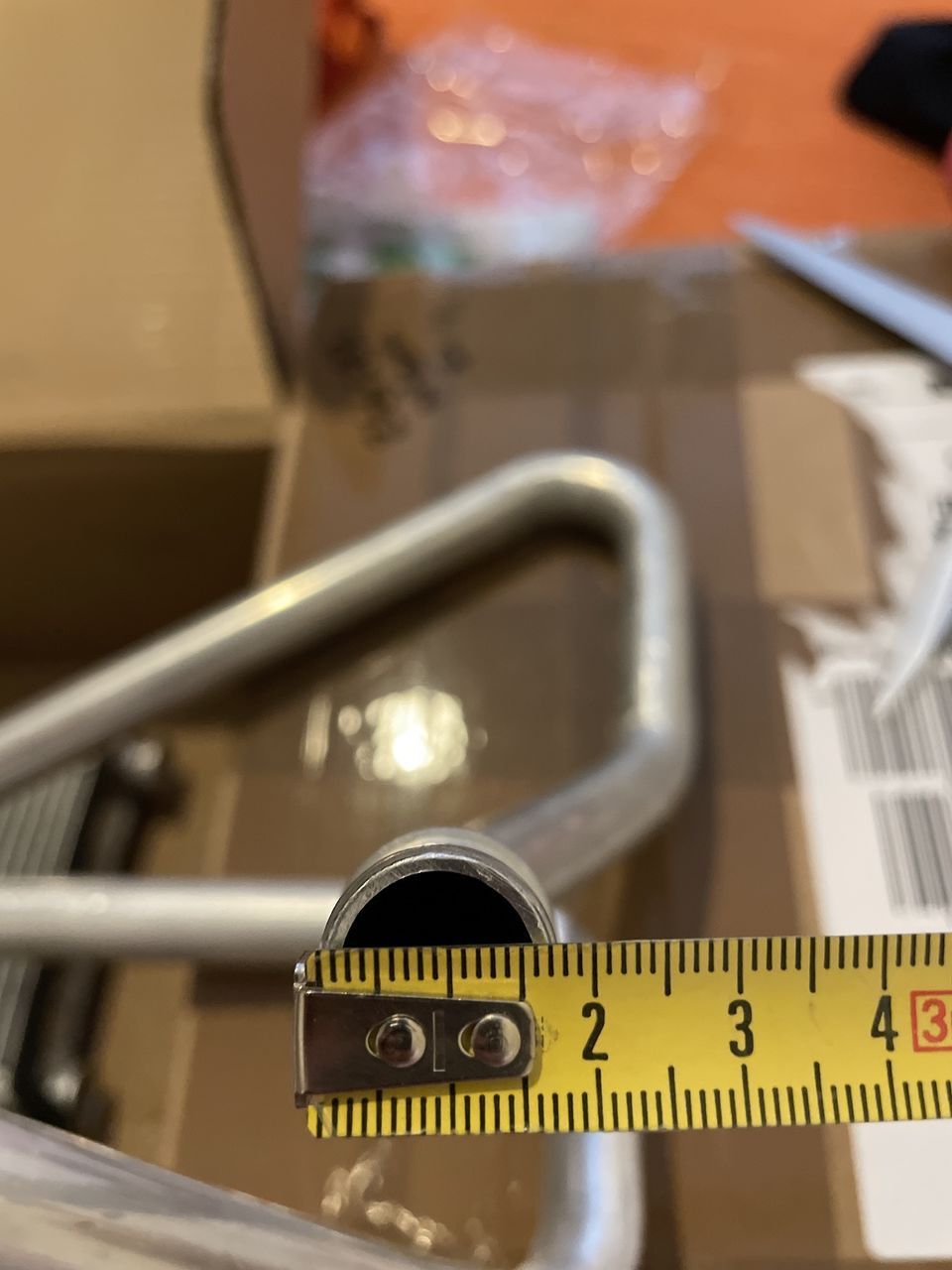

here are some pictures for you. Since you’re in North America (I assume) note that the WIDTH with the measurement tape is in SI units (centimeters) NOT in imperial units. 😎🙈
