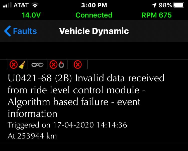

I ran the GAP tool and got these faults:
I find it hard to understand how all of these height sensors have suddenly failed.
I could have searched out all the answers but my troubles are compounded on each other. Where's a good place to start? The height switch?

I reset battery and rescanned the system and found these other faults. Sorry for the size but I don't have time to open up an art program.
Would these faults but the reason why all the height sensors took a crap?

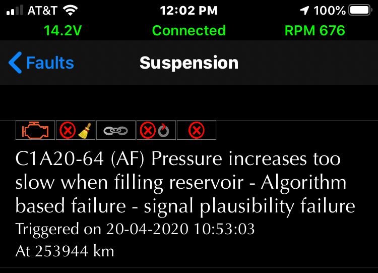

I cleared the faults and the Slow Pressure on the Suspension screen and the Ride Level Control fault returned on the Transfer Case screen (below).
When going into the GAP's Valve Test mode I can hear the pump whirring but it is much more faint. Is it obvious pump that has failed?
