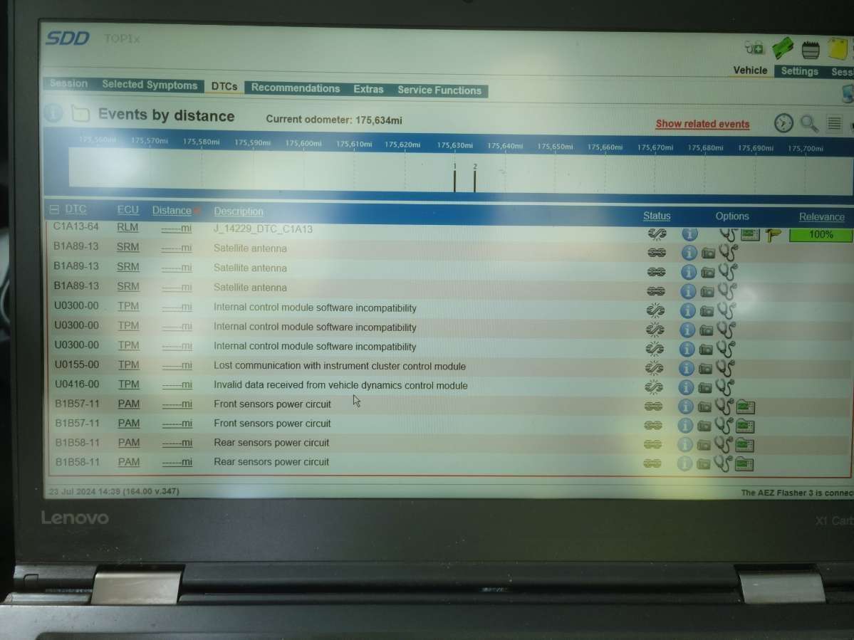

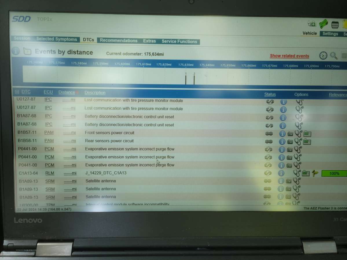

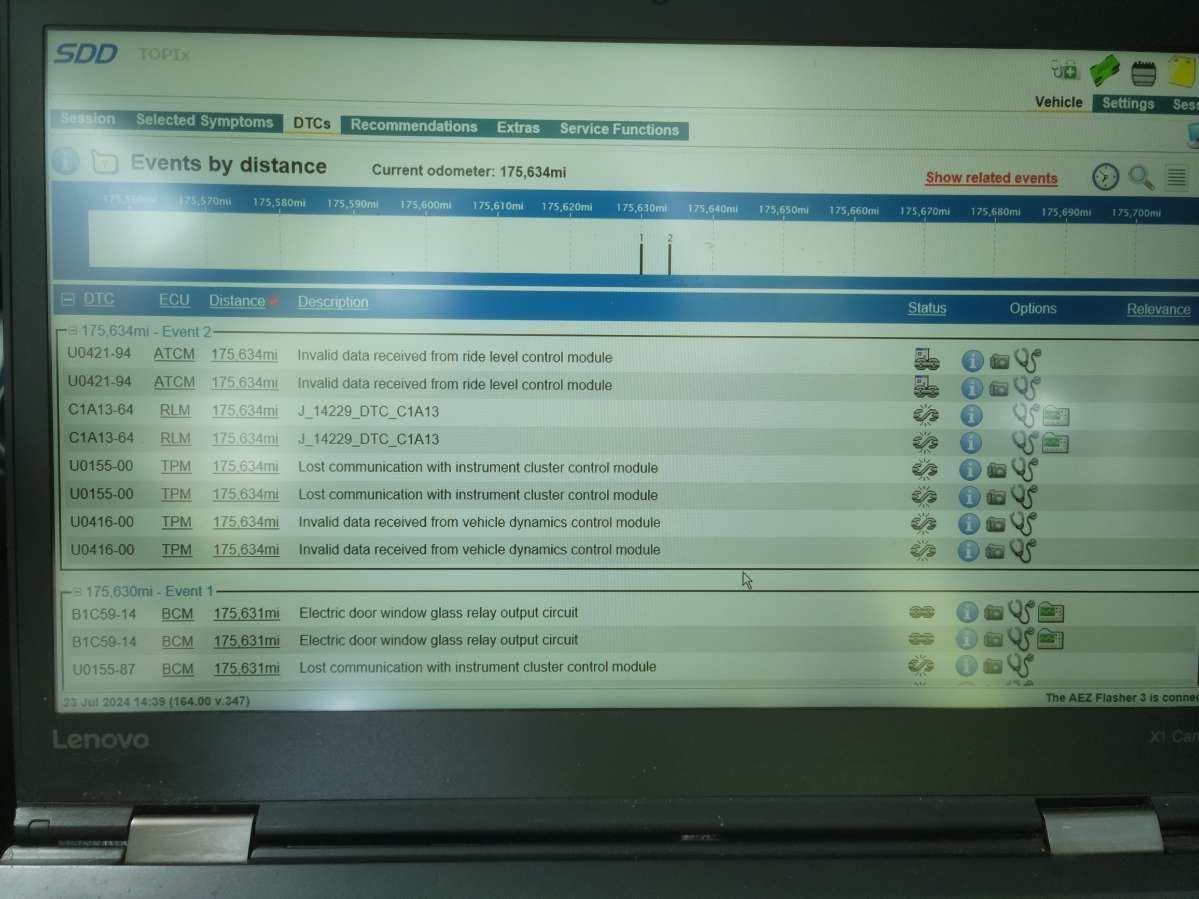

I typically work on Saab with my kids and a friend asked me to help with his 08 LR3. His concern was air suspension and I think I have that figured out with a valve rebuild on the way. My bigger question is this BCM nightmare I seem to got myself into. He has no rear windows, no parking assistance and no tpms. Could all 3 of those be caused by the internal bcm failure I have read about? It's got quite a few codes I'll post so you can decipher if possible. Thanks in advance for letting me join and bother the guys with questions.

That’s a lot of codes, I’d do a hard reset and/or get a new battery if you haven’t already ruled out an electrical issue.
Wet carpets or interior air cabin filter? There’s a BCM module right below the cabin filter. If water is getting in through the fresh air intake under the windshield cowel it will makes its way to the cabin filter and drip all over the module.

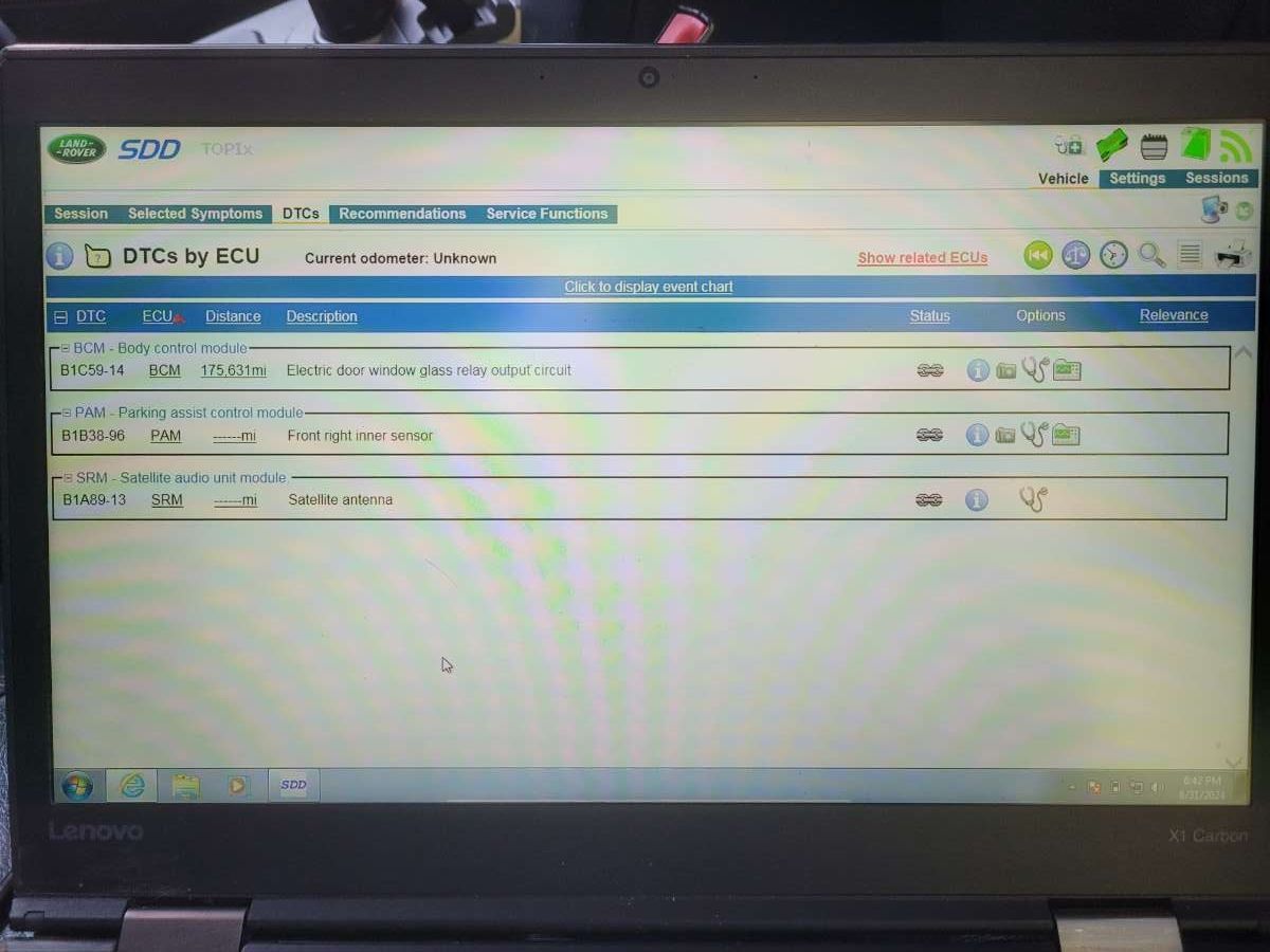

​​​​​​OK, I finally had some time to really dig into things.... Front and rear power to sensors was a dead short in a sensor on the rear. Once it was disconnected I could see there was another bad rear sensor and a front. So we got the new rears installed and the one front is holding me back while waiting on delivery. The question I have is it possible with SDD to disable the front sensors until I get the new sensor, I see the auto on option but it does not allow the rear to function as I'd hoped.

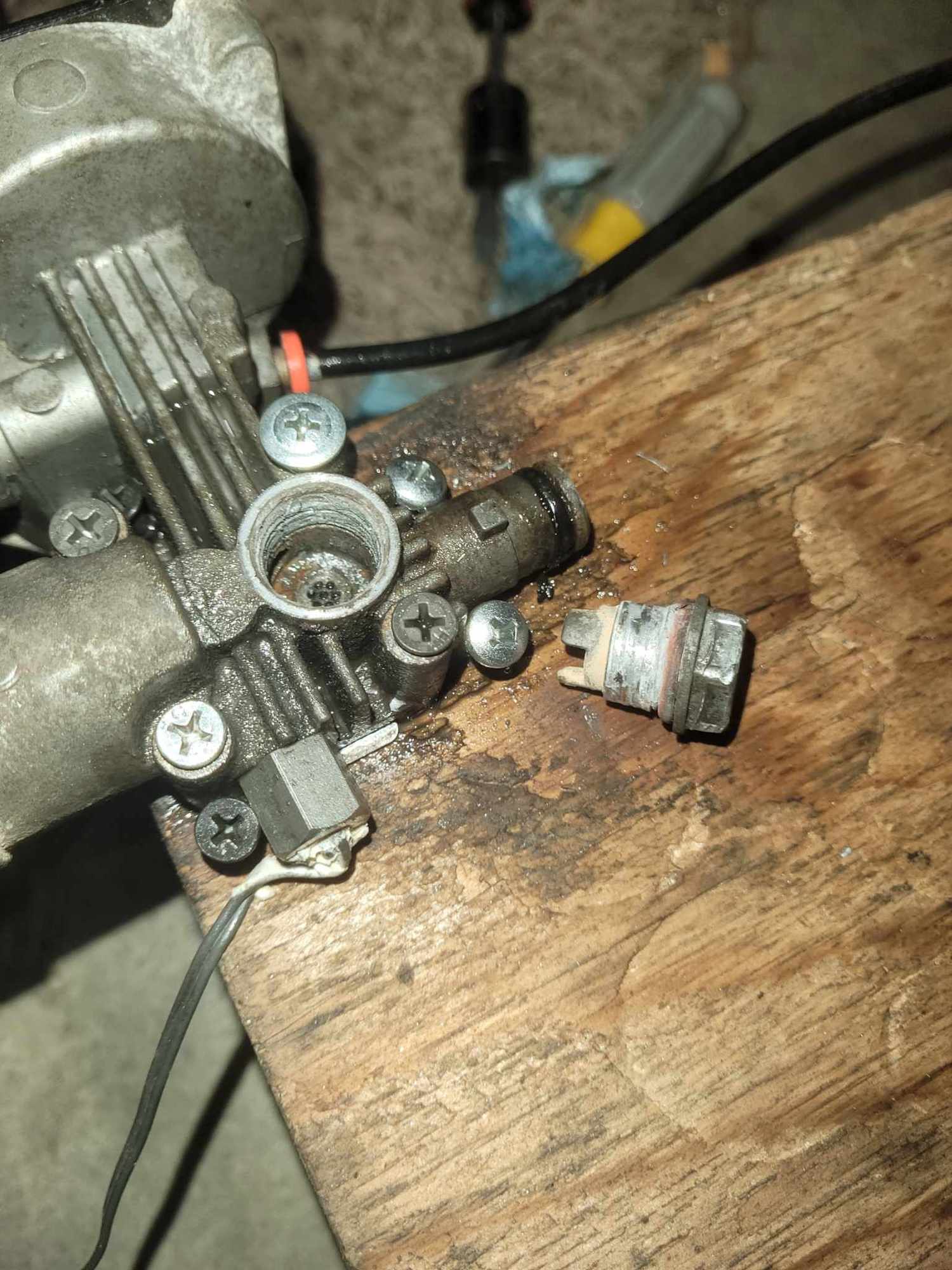

The Hitachi compressor got a dryer rebuild, exhaust valve and valve block cleaning and is filling slow but works now. I'm guessing the metal plate (not sure what is called) above the Piston is worn and I wondered if it was that simple as that. It also got a new air reservoir.

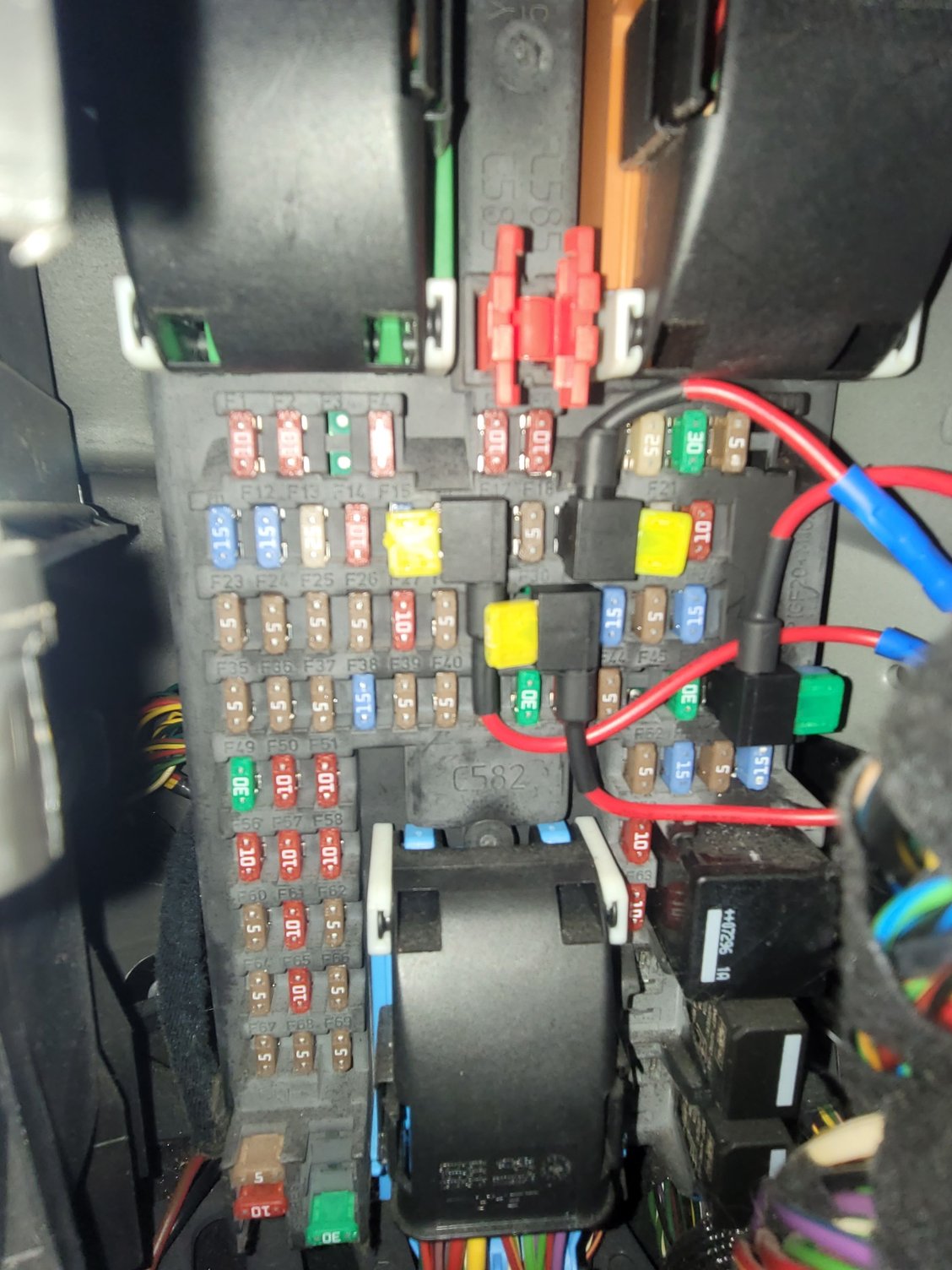

The rear windows was a bad relay in the central junction box and I found a nice work around somewhere that showed how to bypass that relay so we have rear windows again also 👍
Rear window relay bypass
So we are finally down to one dtc for the front parking sensor and one for the satellite radio antenna. And the hopes of disabling the front sensors 🤞

Does anybody know the thread pitch of the delivery valve retaining nut on the LR3 Hitachi? I have searched high and low and even email folks but no replies. I wasn't going to order a new one until I knew I could get it cleaned out.
Old Sep 20, 2024 | 06:01 AM
HeadSPLATT's Avatar
6th Gear
Joined: Jul 2024
Posts: 6
M16 x 1.5 is the size... . Now let's see if we can save this 🤞
