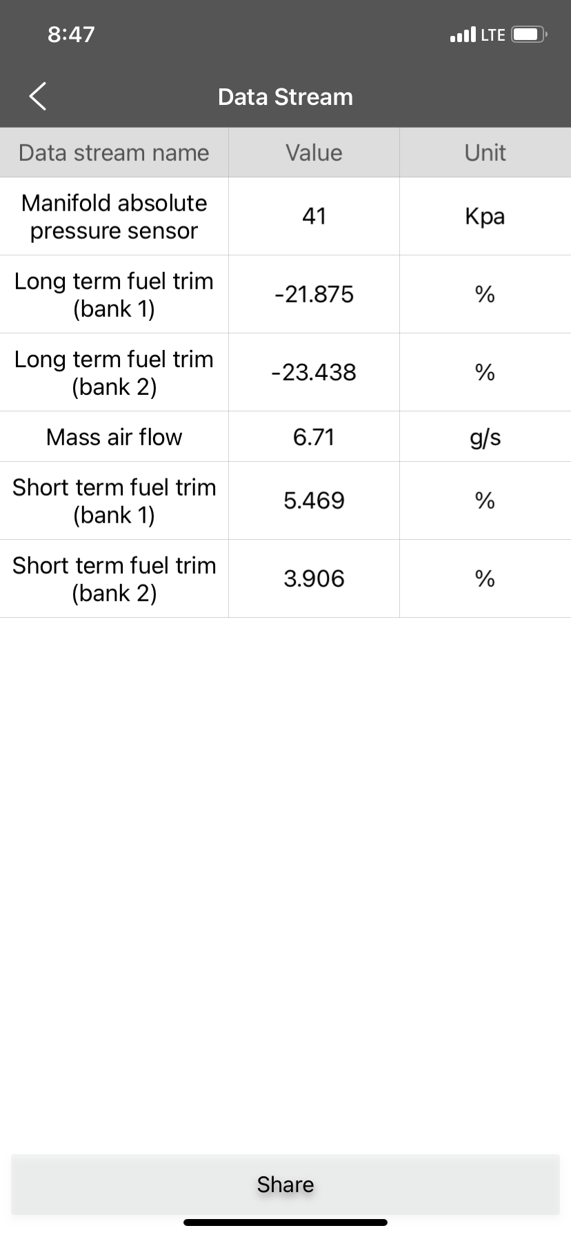

Old Dec 9, 2022 | 07:49 AM
buffalolandy's Avatar
Joined: Dec 2022
Posts: 11
Here is the live data from a few minutes ago at idle. That includes the MAP.
Old Dec 28, 2022 | 06:47 AM
Joined: Dec 2022
Posts: 11
update here on the Landy.... i have replaced the MAP sensor and have replaced and all spark plugs while i was in there.... still no change . I am planning on replacing the CKP sensor and all 4 O2 sensors very shortly to attempt to solve this running rich / emissions issue. any one have any thoughts..... EGR valve? both mechanics have smoked the system and only a tiny bit of smoke come out of it. Carbon cannister?
thank you in advance for your thoughts.....
Old Dec 28, 2022 | 08:16 AM
SeattleDriver's Avatar
Joined: Mar 2021
Posts: 256
Likes: 76
From: Seattle
You need to fix any known vacuum leaks before moving on to anything else. Seemingly small leaks will impact your fuel trims.
If you do anything with the O2 sensors, I would reinstall the old ones you pulled. Those were probably fine.
