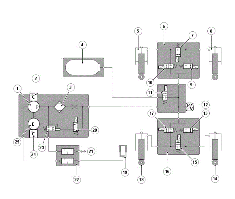

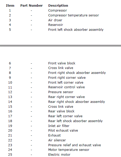

As for the Cross Articulation valve being a problem, it only opens up to the struts and does not connect to the supply line directly, seems that could be the issue if the height sensors become unhappy because of an unexpected change in strut height between left and right. If they are holding air while sitting for a long period, and you are getting a red light when moving, it may indeed be a calibration issue caused by a cross articulation valve issue. Before spending any money except on a GAP Tool (see what I did there?), I would recalibrate the suspension and look at all the voltage for each of the height sensors and see what is happening in the live values as you start driving and notice the change between the dash light off and on. I would also still look at the compressor and reservoir pressures as well
I am attaching a diagram of the air ride system to help you out.
Items 7 & 15 are the valves hoam_wa is talking about.
Hope this helps.
