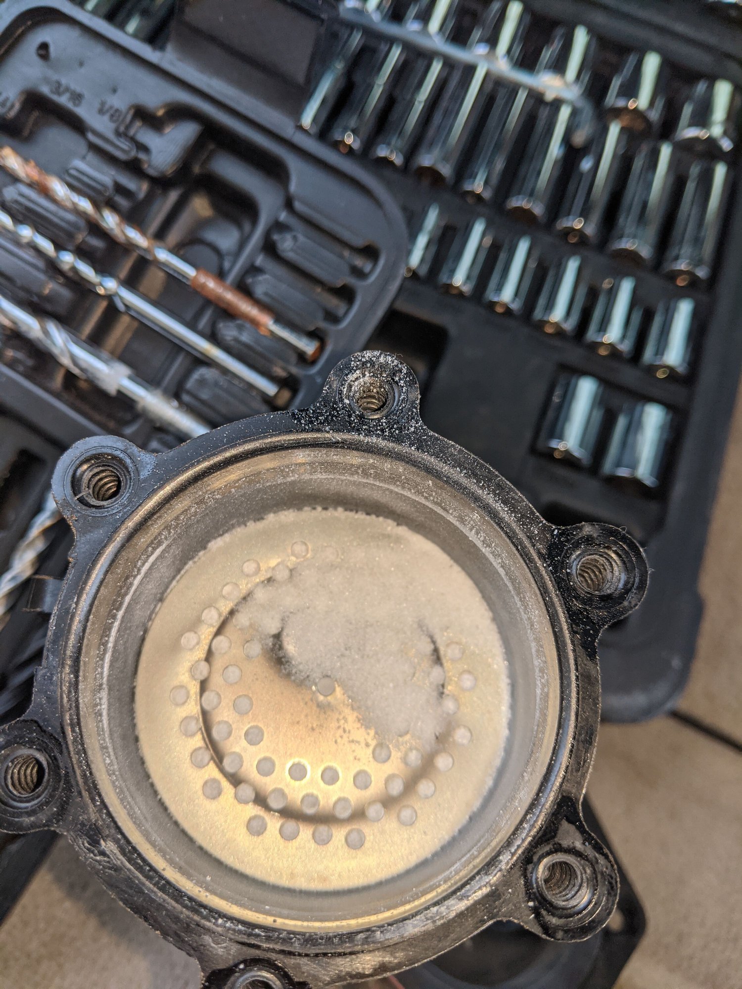

Had the drier replaced and haven't had a fault in three days. Also the compressor seems quiet and doesn't always run on startup, which it seemed to do prior. So I feel like this is a win!
I took the old drier apart. There was white powder, and when I removed that metal plate the desiccant didn't look bad to me but some of it was saturated for sure. I guess I don't know what it's supposed to look like.
I'll upload some pics.

The powder is the desiccant breaking down and clogging the filter and that perforated metal plate, the compressor i have fitted now i got as a freebie that the owner put a rebuild kit thru but didn't clean that plate.
I cleaned it out and baked the desiccant in the oven and its been good for nearly 2 years, i rebuilt my original hitachi and it sits under the back seat as a backup.

...I knew what the powder was. My real question is how much powder indicates there is a problem? How much discolored (saturated) desiccant is indicative of a problem? I have no basis of comparison.
Majority of it looks ok but doesn't take much to block the filters or migrate down the lines into a valve block.

I almost want to say that the descent maybe was quickly replaced at one point. It looks good, yet that is a decent amount of powder considering how it looks. Usually when I see powder it all looks like crap.
