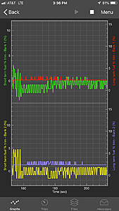

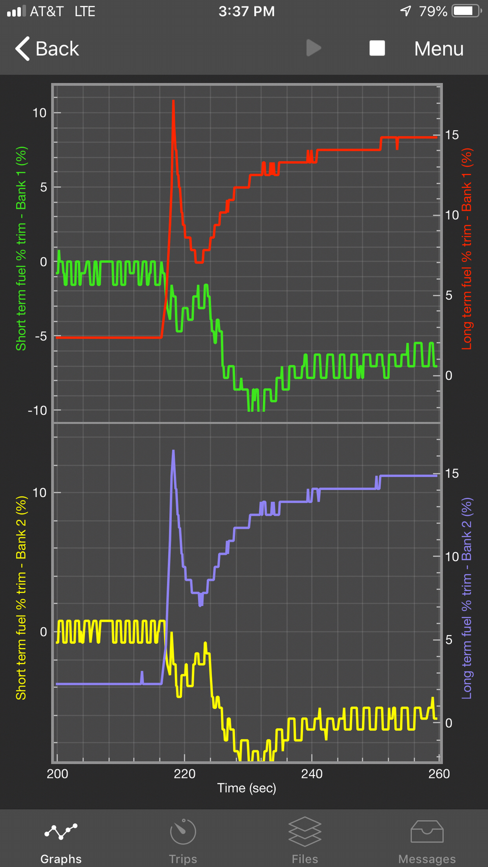

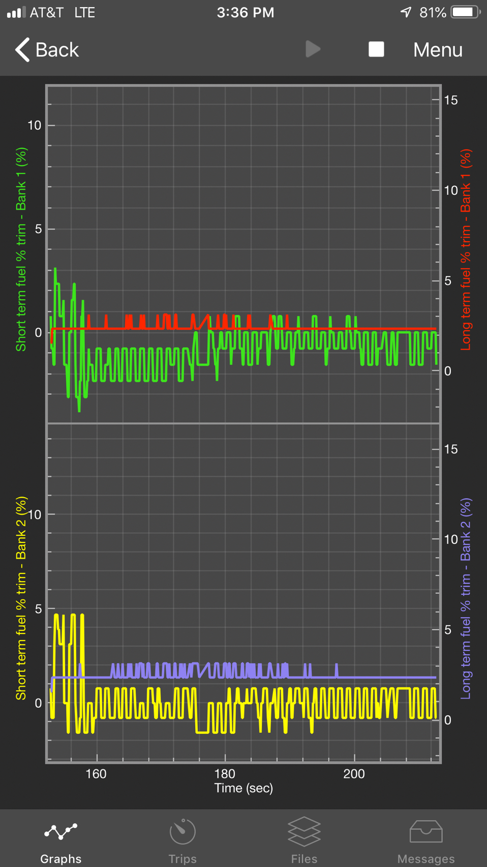

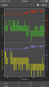

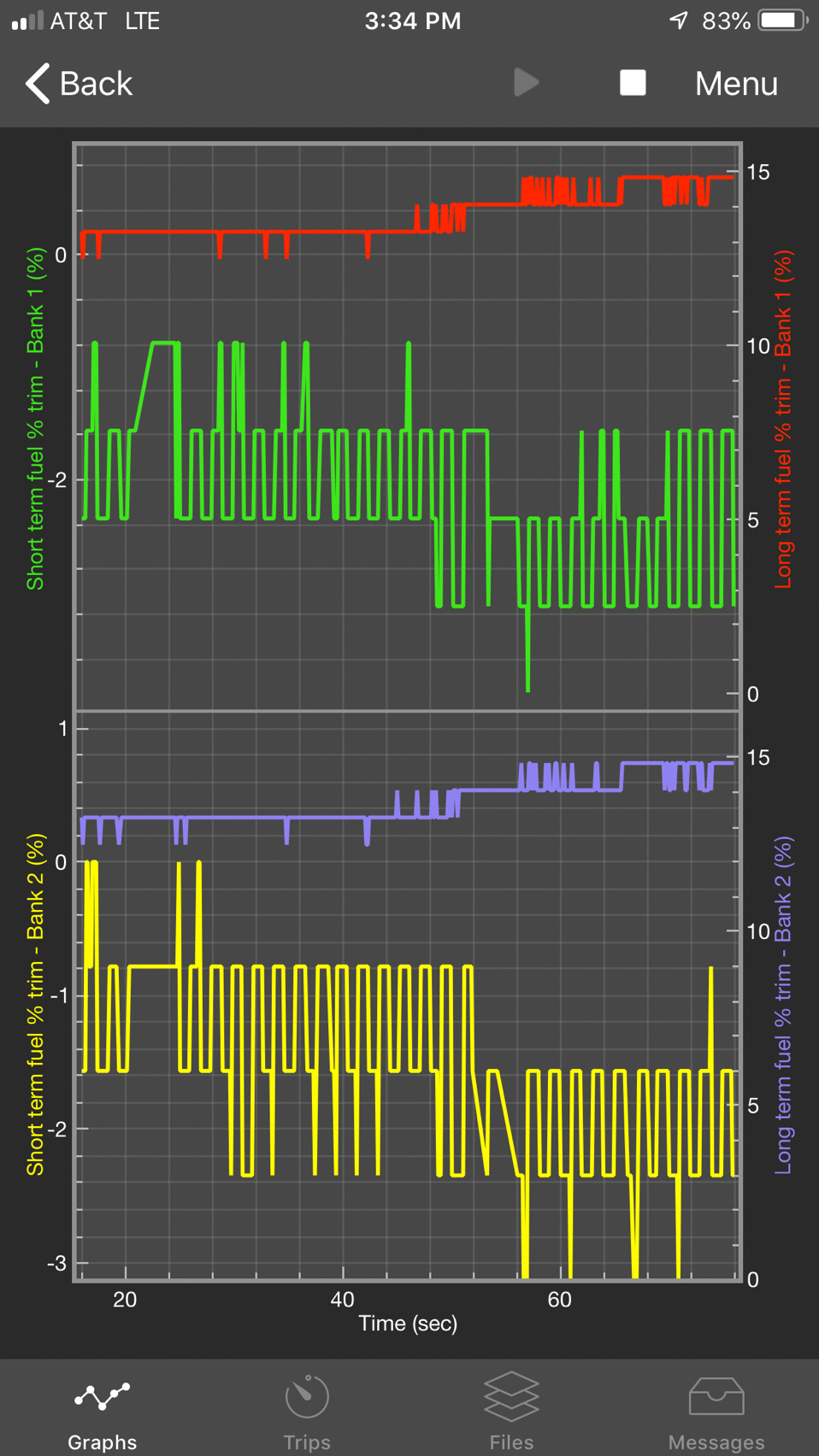

Here are 3 graphs of my fuel trims. All for 1 minute time frame.
1 is at idle with high deviation in long term trims both banks. Weird.
The other is at 1500 rpm constant. Long term comes back In good range.
The last one is letting off throttle from constant 1500 rpm and you can see the long term swing back.

Well, I like to think that some problems like this are caused by faulty sensors, so I'd suspect a look at this site might help (
) get you on track. Unfortunately, your graphs showed variances on both banks at the same time so I'd suggest that there is something common like fuel pressure (? good for you?) or perhaps an air intake problem? I am no expert but it seems odd that both banks react similarly at the same time, and that the problem goes away after warm-up...
