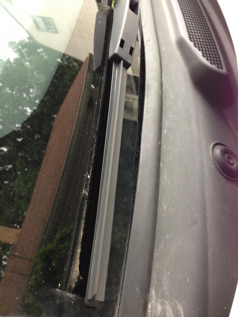

I've attached a pic of my gap

Originally Posted by Dirt Roamer
Thanks a lot! I've ordered the A piller repair kit and will tape up the cowl. Hope this does the trick.
You need a cowl.
You can have it resealed, however in my experience when they're warped like that, a reseal usually does not last that long. The cowl is not terribly expensive, and a pretty simple repair. I would stay away from taping it down, and if you choose to reseal it, use some RTV across the entire upper edge, then with some masking tape on there for a few hours for the RTV to cure.
