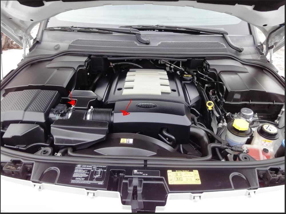

I might be misunderstanding which area in the intake you're referring to, but a leak *before* the MAF sensor should not affect anything or contribute to your lean codes.
If the leak is before the MAF, then it's not unmetered air - which is what you try to eliminate with a smoke test.

I'm replacing that same part. Red Arrow 1 (to the left) connector is very worn and doesn't have much life. Red Arrow 2, to the right, indicates where the hose connects to the throttle body (couldn't find a picture without cover) and shows a significant smoke leak.
I disconnected the air box at red arrow one, after the MAF, got a snug fit and smoke tested. Red arrow 2 is leaking and evening tightening the hose clip (broke an old one), doesn't seem to affect the leak. So I reckon this is probably more of a culprit for me than the EGR. But, will a new part give a snug fit and stop the leak or will it continue? I guess that's the question you are perhaps asking?
