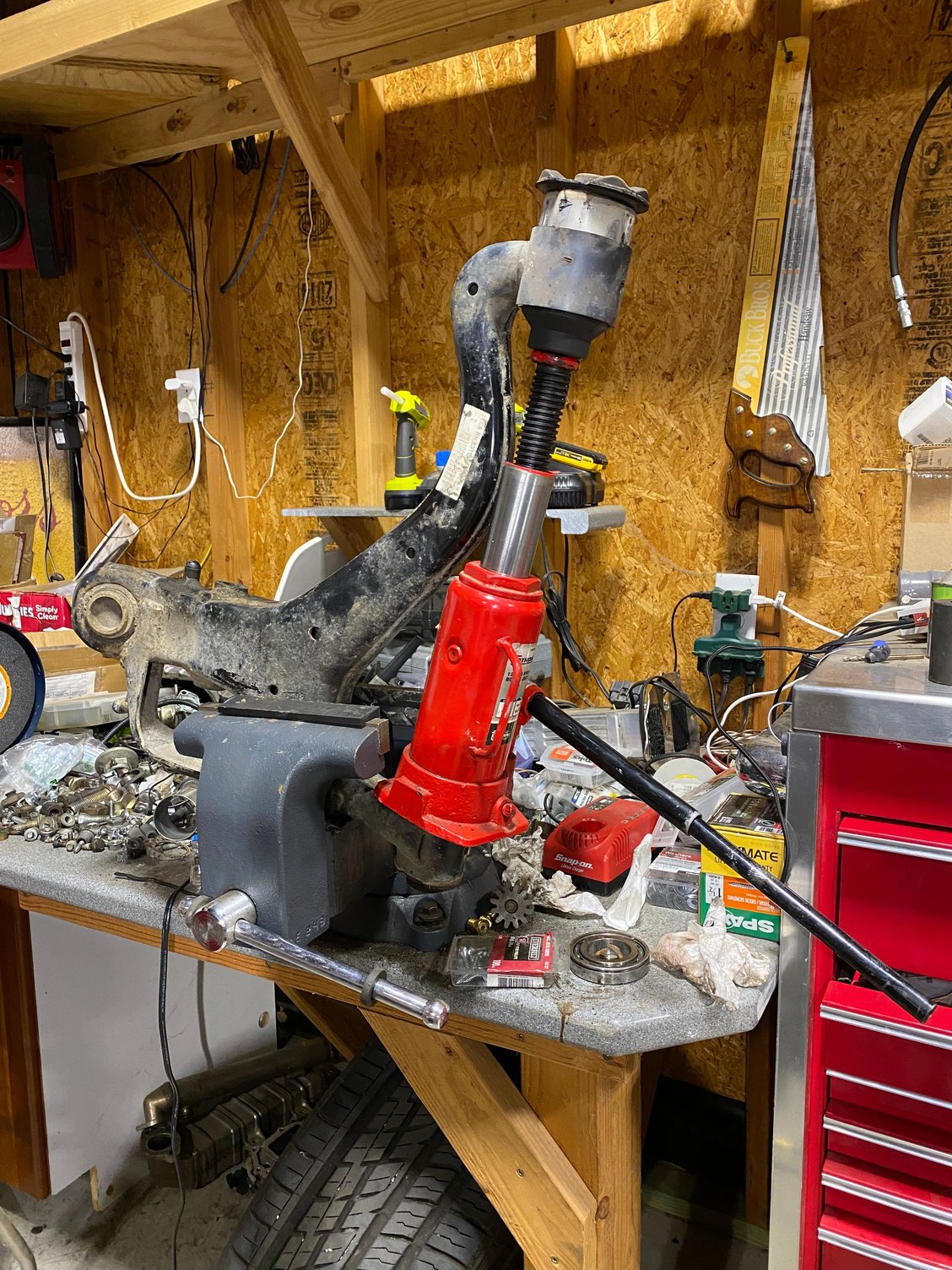

I did this... It's definitely the HARD way. I have a 20-ton press, but I still needed to use a bottle jack, an air chisel, and a torch to get the old ones out and the new ones in.
DELPHI TD936W Control Arm Bushing 2
DELPHI TD1377W Control Arm Bushing 2
DELPHI TD1494W Stabilizer Bar Bushing 1
LEMFÖRDER 2958901 Ball Joint 2
LEMFÖRDER 2959001 Ball Joint 2
LEMFÖRDER 3438801 Control Arm Bushing 4

This is how I extracted the old lower bushings. I can see how they could bend. I brought mine to the point they began to bend, then hit the collar with a mapp gas torch and the bushing popped loose. Scared the h outta me the first time.
