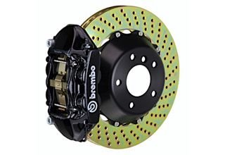

Here is an example of brembo brakes. I just looked up Range Rover brembo brakes so these are probably not the model that fit the LR3. Brembo brakes do away with caliper brackets or caliper carriers. Just a massive thing that straddles the disk and bolts on where the bracket/carriers do.

I think those are the 4 pot Brembos, there is an even larger caliper with 6 pots. Both can be made fit, the rims will be rather limited and you might need spacers.
