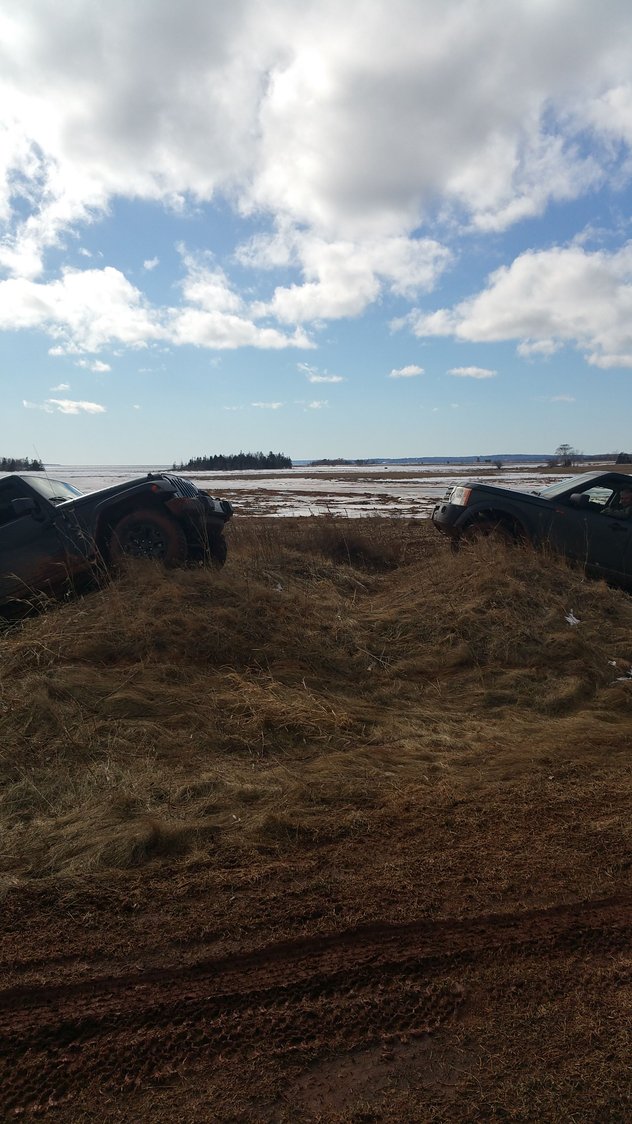

....13" of ground clearance, and it articulates!! No reason to get rid of it. I was harsh on those posters, especially after you opened the flood gates, Dave!
...but there were a lot of holes and outlandish statements.

For those considering a coil conversion, I experienced something on January 1st this year which made me realize the increased value of EAS when off-roading. While returning from exploring, I was going uphill on a steep, snow-covered, rutted trail when the vehicle came to a halt even as the wheels were turning. My LR3 automatically raised to extended mode as shown on the message center in order to rise above an obstruction and then continued right along. I will gladly pay to keep the system functioning as designed since I place a very high value on not getting stuck.

I did the Atlantic British conversion with the plus 2" about 6 months ago, I do quite a bit of off road, I live on a farm and my friends and I play quite a bit in the local shale pit.
Thought I'd share my experiences with you.
A little history first, I'm from the UK raised in the Highlands of Scotland on a farm, family had Landies, defenders and RR as long as I can remember....Now in Eastern Canada, before buying my 08 LR3 I had a disco 2 that also had been converted to springs long before I got it, did lots of mud splashing and snow treks with her.
Bought my LR3 about 2 years ago, ran with the air suspension for 18 months, had constant issues with the system, tried and spent 1000's on trying to fix it, all to no avail. I liked the suspension, I bought Johnsons rods to raise her when needed as i do quite a bit of mud flinging and off road driving, they worked well when I needed the extra height...about twice.
After 1000's of bucks of repairs my air system still kept failing, the final straw was when I was left stranded a long way from home, I decided to get the conversion.
The shock spring conversion I bought has the old man emu set up, gives me the 2" from stock height raise.
On the highway, I really don't notice any difference vehicle is tight and with my 19s and snow tires I feel safe (it does not run or feel like a jeep) my friend has a 2016 ***** jeep and my ride is a lot smoother), off the highway I feel just as confident in my vehicle. Though I have had one situation where a lift would have been nice to get me out of a snow hang up (nothing a winch out didn't fix).
So bottom line, I loved the air suspension, it was cool, when it worked well it was great, but honestly I really don't notice much difference at all, certainly not one that would make me go back to the stress and cost of the constantly failing air suspension...nothing wrong with either, I actually prefer the shocks and springs.
