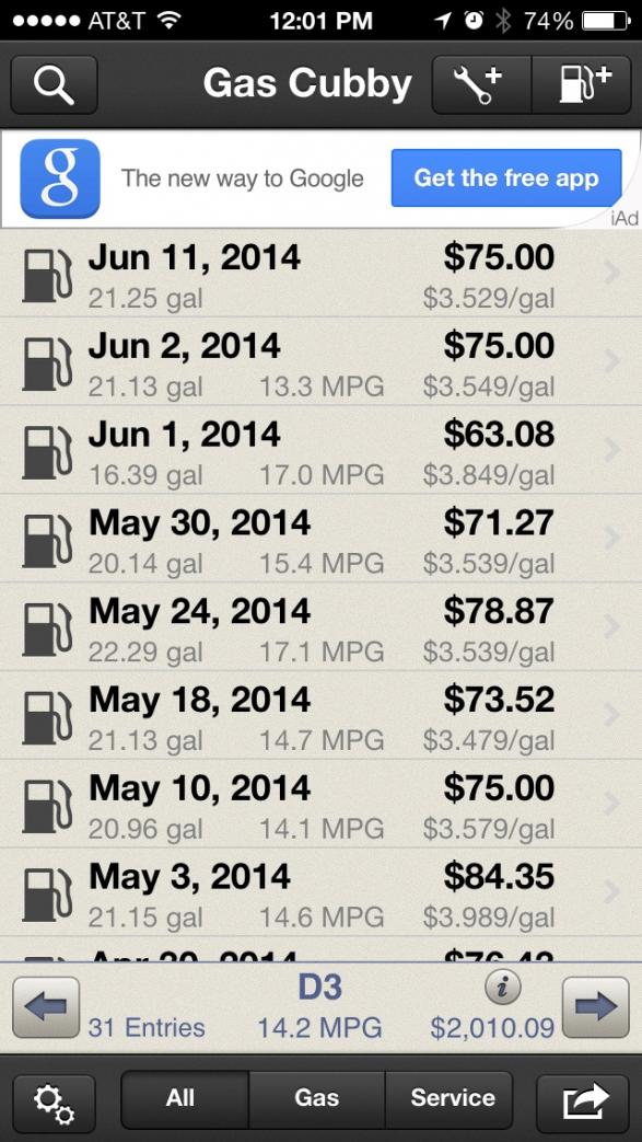

Sometimes I get lazy, now that gas has gotten so expensive I cannot fill up before the credit card limit of $75 is reached, and so I just stop there.
