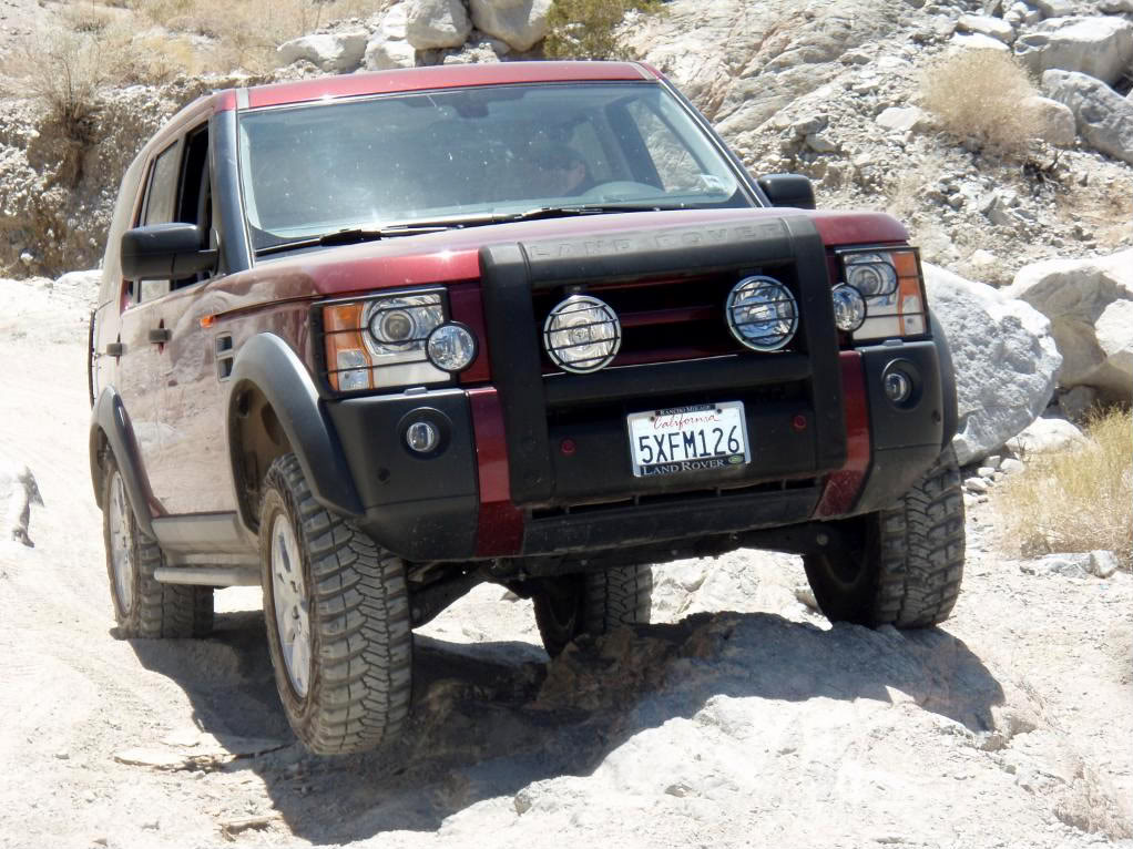

When considering Johnson Rods vs the IID tool, a factor to consider is the wheel camber. With the Johnson Rods install full time, an alignment will correct the wheel camber and allow the tire to travel flat over the terrain thereby improving traction and performance. With an IID computer lift done at the trail, the tires will travel on their outside edge decreasing performance and adding stress to the out edge to the tire which is not good. So choose which way works best for you, but my recommendation is to have the Johnson Rods full time with an alignment and proper camber to improve performance and reduce stress on the wheel and tire. Notice how my tire rides flat with the Johnson Rods in the picture blow. This is the optimal way to set up the vehicle for off road use.
