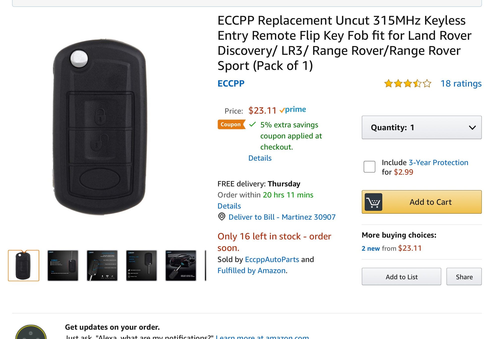

So i heard back from the Land rover Indy. It is an issue with the key and the car stopped recognizing it. they want to order one for $540. Before spending i want to see if the amazon keys would work? does anyone have experience with amazon keys getting them cut and programmed?
thanks
Old Feb 4, 2020 | 01:06 PM
I have used amazon keys with good result but I don’t think you can program one without a functional key.
Old Feb 4, 2020 | 01:08 PM
Kushan Gunawardane's Avatar
Joined: Oct 2016
Posts: 102
do you remember which brand you got? Theres a few with mixed reviews on amazon. As for the non functioning key i figured ill try my luck on amazon before ordering from dealer.
Old Feb 4, 2020 | 01:23 PM
They are not rechargeable but so far no issue there. I will stress again I do not think you can program one of these without a functional key.
Old Feb 4, 2020 | 01:27 PM
Joined: Oct 2016
Posts: 102
Thanks for the reply. If not this my other choice would be to pay $540 and will take 2 weeks or more. Specially since they are on back order.
