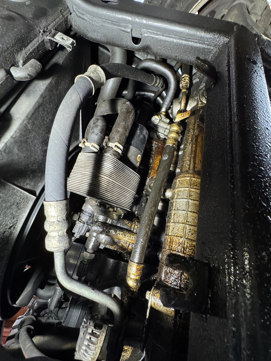

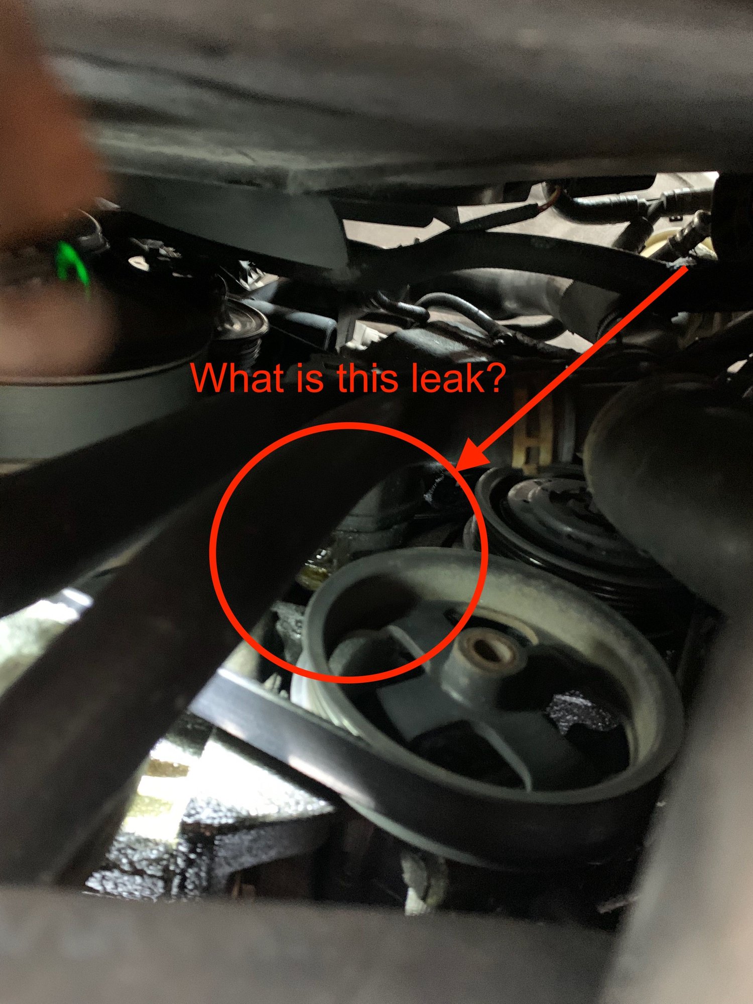

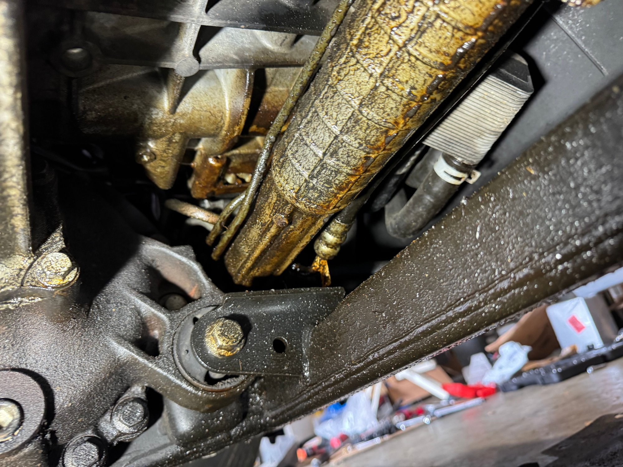

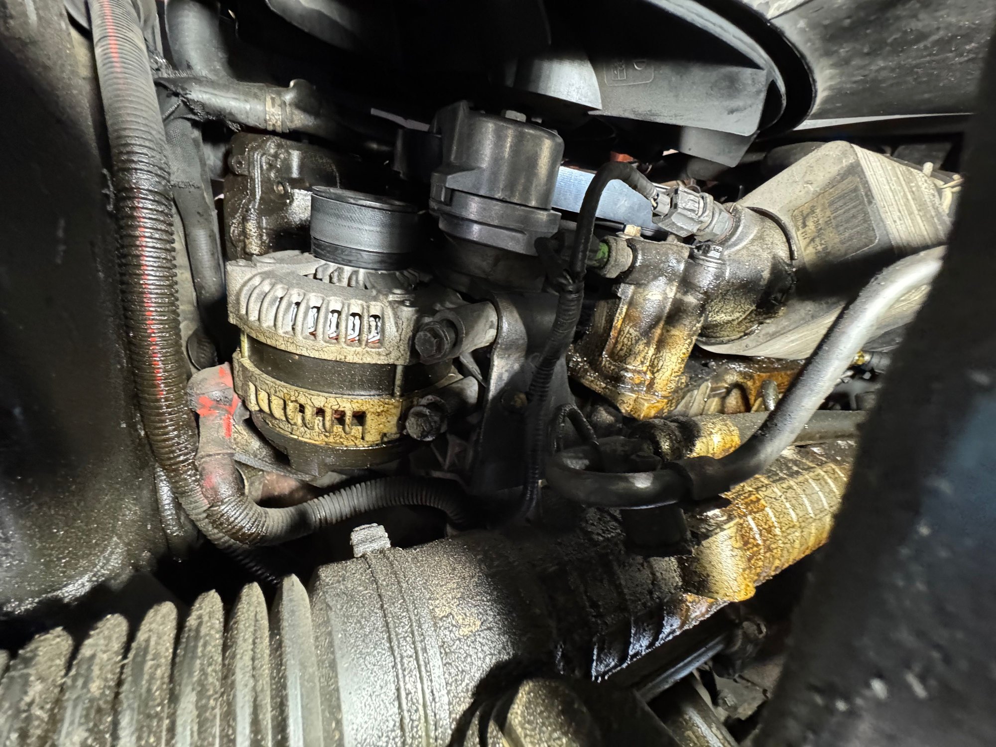

hi Sir, this looks a lot like my leak. See picture. I am trying to understand which bolts might be the oil filter housing. Can someone point them out?
