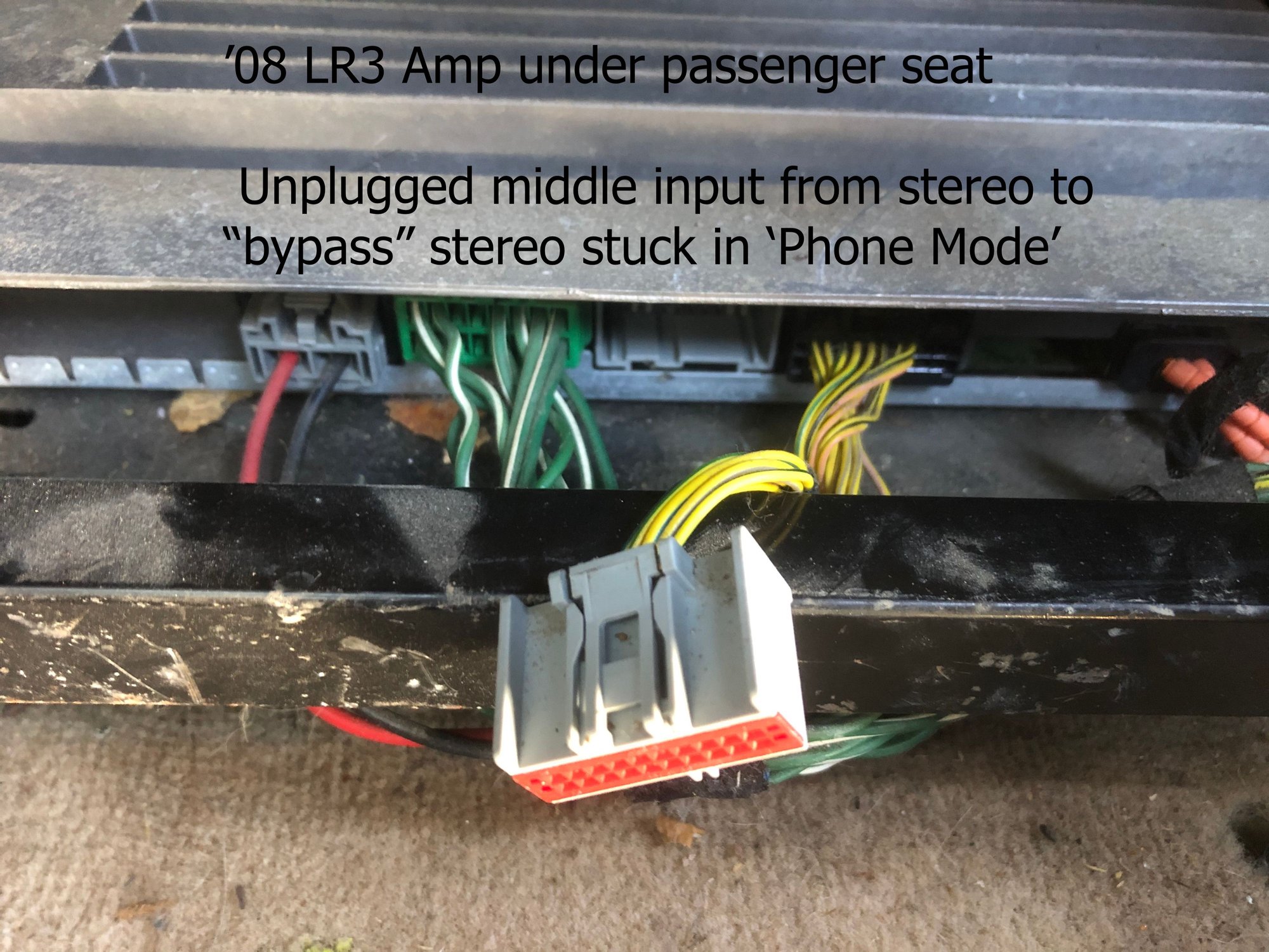

I hope this gets to some people still looking for solutions about getting stuck in "Phone Mode", as I've been searching for ~9 months and tried everything recommended across various forums :: hard resets, pulling fuses, etc. I originally started having this issue on and off for several months, would have a few good weeks being fully operational and then it would stay locked up; I've been fully locked out of the stereo for the past 7 months. I had tried everything that had been mentioned online.
I basically spent an afternoon pulling apart the dash/head unit to troubleshoot, I suspect it has something to do with the phone toggles in the steering wheel and the interface with the stereo but still TBD. What ended up working for me is pulling the dash apart and exposing the stereo wiring to try and work back/isolate the phone/bluetooth interface to disconnect. Not sure if I actually accomplished that, but I ended up unplugging/leaving unplugged what I assume is an phone/bluetooth input from stereo into the amplifier under the passenger seat. VOILA, stereo resurrected. Still not sure if my assumptions are correct, but the stereo is fully functional now and feels SO good to be working again. I have left it unplugged for the time being and will update if I learn anything else.
Pic for reference.
