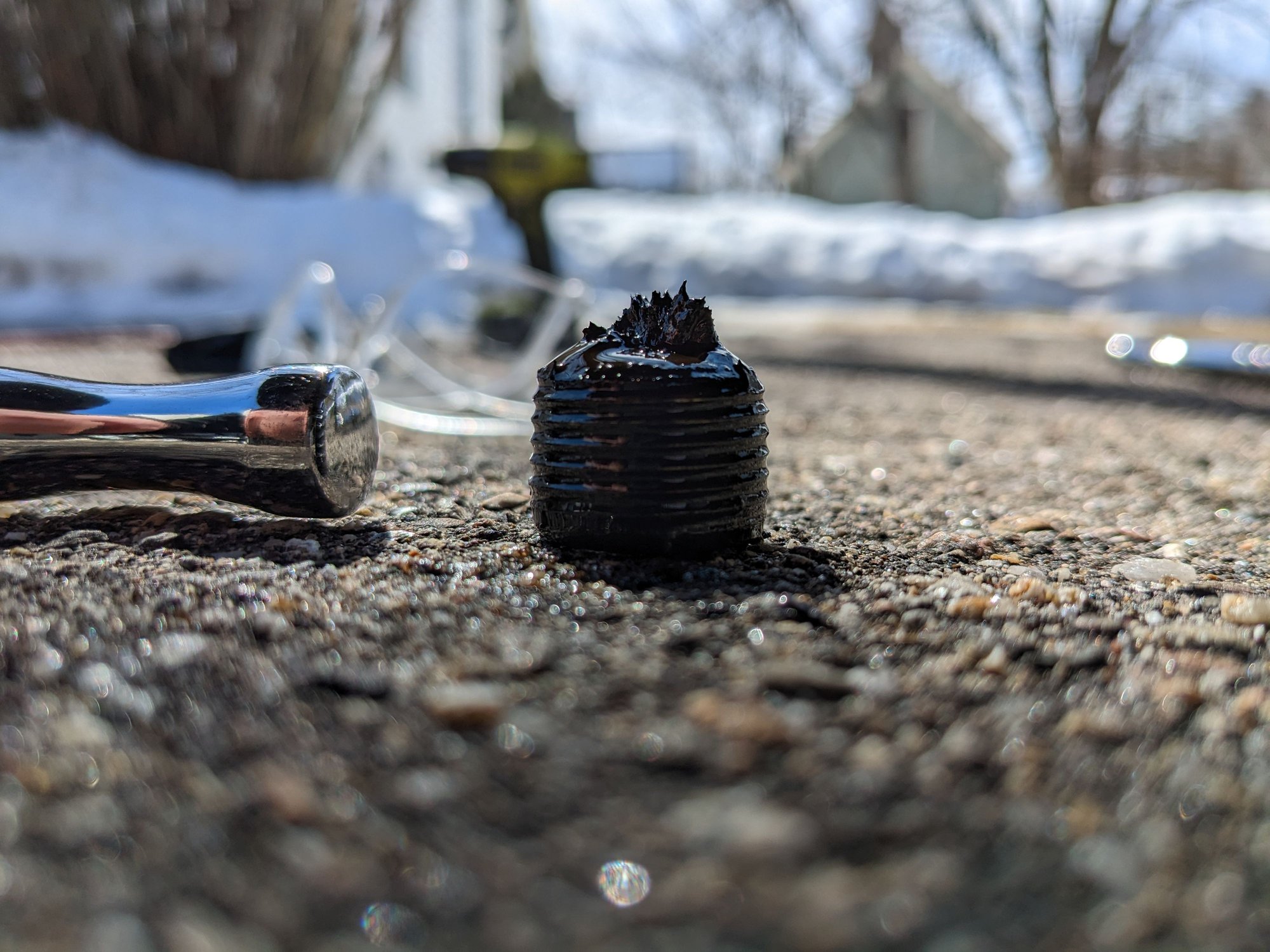

Holy giant picture...but I got stuck. Can't get the bolts on the diff to budge and I need a break so I'll get back to it tomorrrow. Pic is of the rear diff drain plug (the bad one). Lots of shavings on the magnet, I'll post pics of the inside once I get the job done. Any tips besides heat on the rear diff mounting bolts?

Those don't look like shavings, they look like metallic sludge. You need to remove that material and wash it to really tell. But to me, that looks very normal.

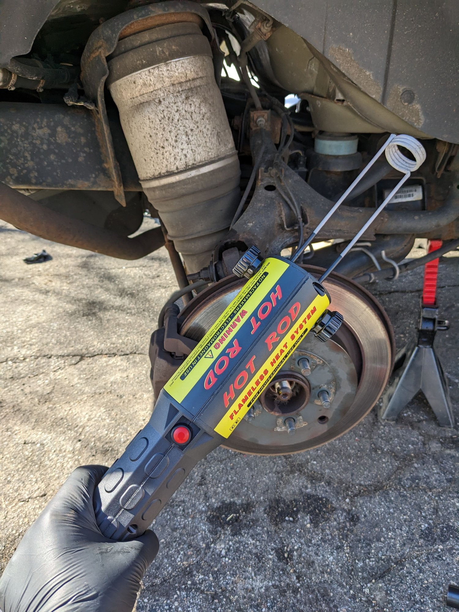

Well I got the new diff in over the weekend. Quick shout out to this relatively cheap induction heater. Worked great for me and I don't think I could have done this without it. I'll try to get some pics of the old diff next weekend.
