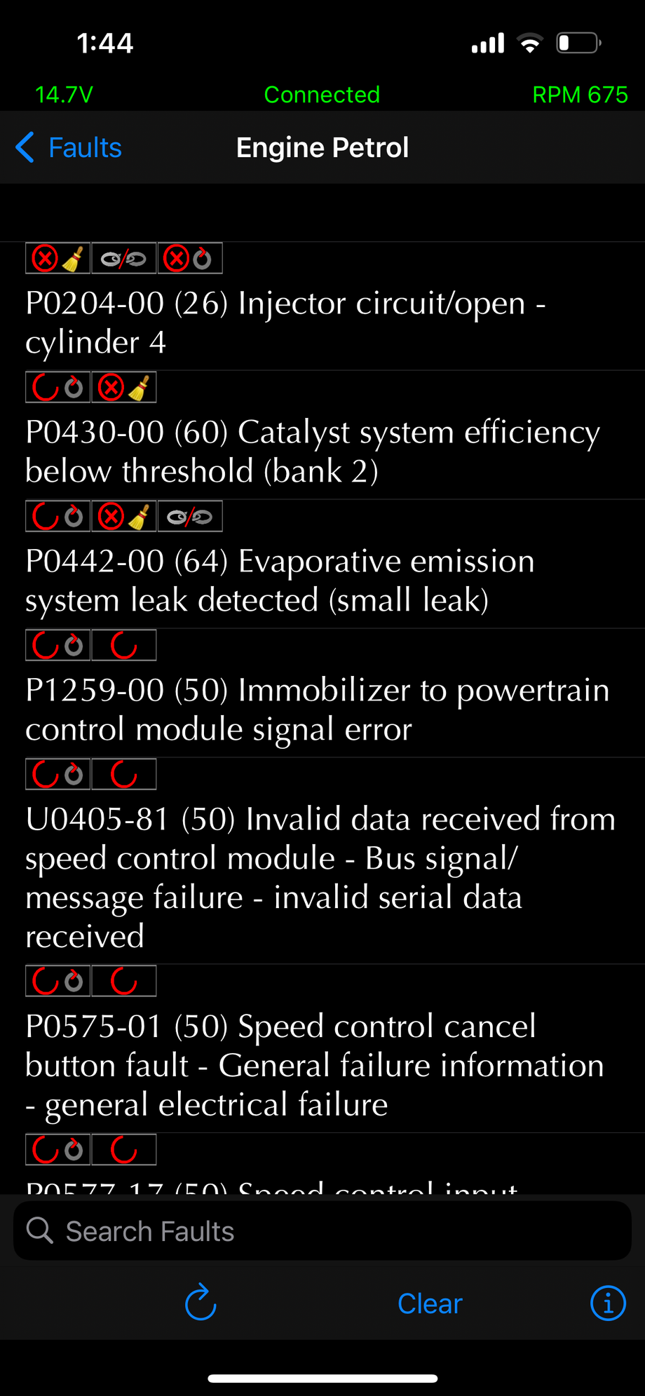

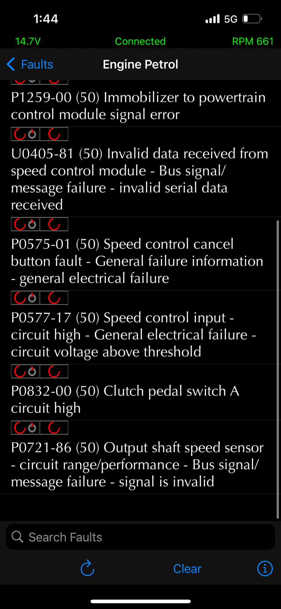

Yesterday I started up the LR3 to go run some errands, it had been sitting for about a week since it ran last. The CEL was not on but I could feel the engine running rough, so I pulled codes with the GAP tool:
Initial engine fault codes 1/2
Initial engine fault codes 2/2

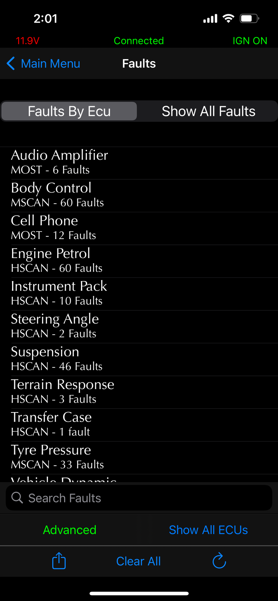

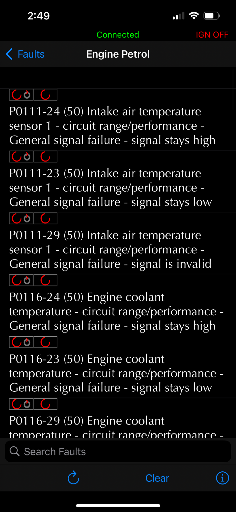

I tried clearing all faults to see what would return and even more codes showed up and not limited to the powertrain ECU They seem to be conflicting codes, or just no value errors:
I checked the battery and it was over 12v, and measures 14.8v while the alternator is charging. I don't see any AC voltage so I don't think AC ripple could be an issue. I thought it might still be a bad battery, but the parts store would't take it back under warranty since it passed their testing.
​​​​​​A couple times this summer I had noticed it taking 1-2s to fire, then stumbling for another second during cold starts, but it would always be run fine without any codes. The battery voltage has occasionally dropped to less than 12v (measured with GAP tool) if it has sat for a while. Is this on it's own a definite sign of a bad battery?

I would suspect the battery at 11.9v is causing a lot of these faults.
