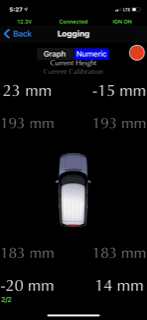

Thank you both for your reply. Having some difficulty with the IIDTool as it saved the lifted heights in the CCF and when I try to go with the guided set up, it will not accept as the new measurements are beyond the parameters (150-250). Here is a pic. The left Front seems to be the biggest issue.

...is that with the stock rods on, or the lift rods?

That is with the lift rods back on. The baselines with them off were over two hundred. I am going to take it to the mechanic to re-calibrate tomorrow morning. Going to see what he can do with either lift rods in or stock rods in. He does not have time this week to remove the SYA's but will get it safe for my week long vacation starting Friday. The spacers were pre-mature as I am running 265/65/R18's. The spare fits under the truck after deflating somewhat. The ride quality lifted was poor and I kept getting stability alerts and some suspension faults. Most likely a calibration issue but I do far more freeway driving to get to offroading/overlanding than I do driving offroad.

I'm not sure what you mean by the baselines being over two hundred...you talking about the real-time measurements in mm or the calibration live values? I guess I don't see how the mechanic might be able to calibrate it any more easily or successful than you can with the IIDTool.
What have you actually attempted to do with your GAP tool? Have you walked through the "Guided Calibration" and failed? Nothing you describe above sounds like the Guided Calibration. I'd suggest putting on the original rods and trying that Guided Calibration. Don't worry too much about the live calibration values; they are arbitrary constants.

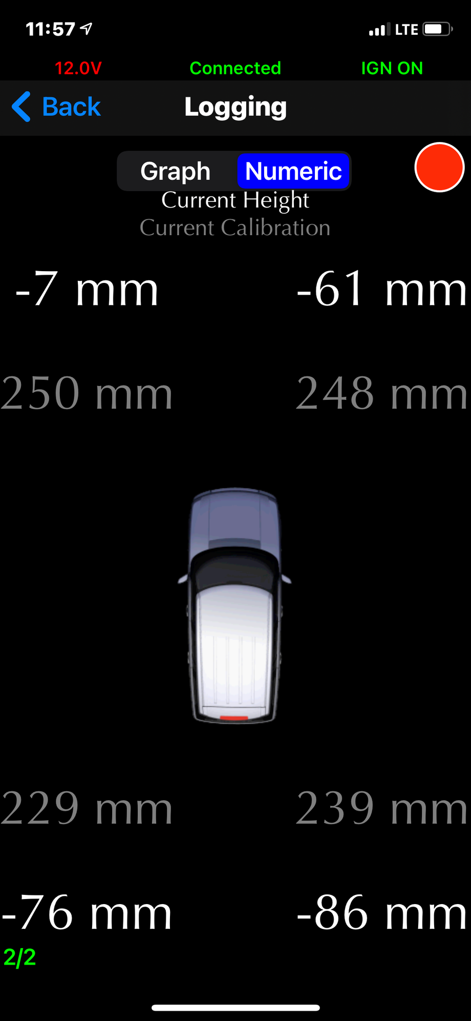

I appreciate all your help so far (sorry was away for a few days). So I took the car to my mechanic (he could not fix). I put the stock rods back in and we tried to go through a guided calibration. The Front left sensor is failing the calibration. I was looking to do 520 mm in the front and 530 in the rear to accommodate the spacers. The car is running at 470 in the front and 500 in the rear and the air shocks are compressed and bouncing off the bump stops. Here is what the tool is saying

You need to set a baseline calibration. All set to 200. Did you do that first?
