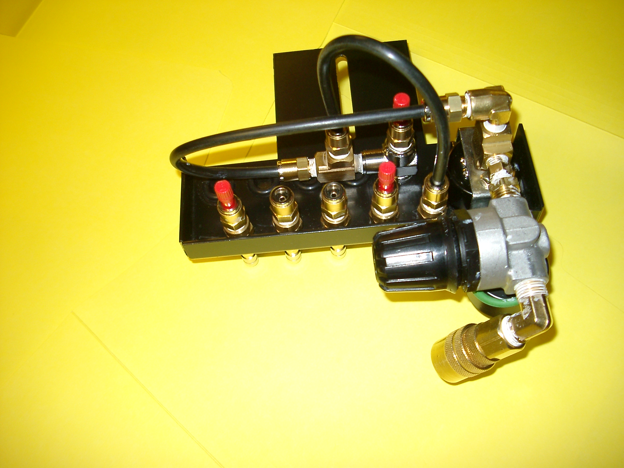

The link below is to a section in my gallery related to what I will call my initial mechanical solution to the air system.
DISCO3.CO.UK Photo Gallery - FASKIT Air Suspension Installation
The jpg's below are what I eventually modified the initial mechanical system to be.
Basically I tapped off the air tank, (the Schrader valve marked AIR), so that air could manually be injected into each air spring, one at a time, as required via a short jumper air line. This design reduced the number of required valves and hence leakage points. The major downside was that by running separate lines from each of air springs, I increased the amount of air line within the vehicle by at least 3 times over what the LR factory system used. The two lines from the front two air springs did not add much air line but the two from the rear added about thirty feet of 6mm DOT airline by the time the air lines wound themselves into the engine compartment.
Therefore the major problem with the concept was that the solution effectively introduced more failure points into what one must say actually is a fairly reliable factory system. Each air spring line now had a tee within adding leakage points and freeze up locations as the tees are most often metal whereas with the LR system unmodified, there are no tees.
It was from those concerns that evolved the "pull the fuse" procedures. The primary advantage was that the concept then used existing LR design components to effectively bypass failure points.
Attached Thumbnails Manual EAS Override???-faskit-single-valve-topside-imgp0710.jpg   Manual EAS Override???-faskit-single-valve-underside-imgp0703.jpg   Manual EAS Override???-faskit-single-valve-underside-imgp0704.jpg   Manual EAS Override???-single-valve-air-system-flow-drawing-07.jpg   Manual EAS Override???-faskit-single-valve-underside-imgp0742.jpg
