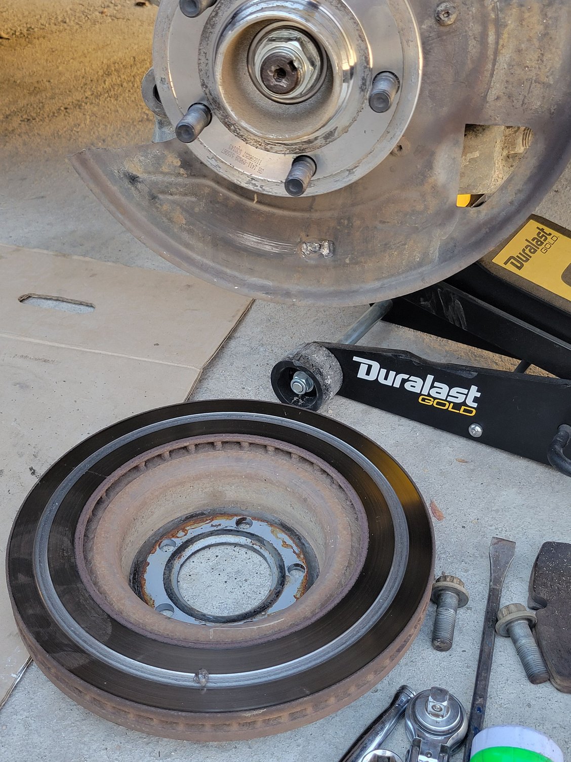

I am starting to wonder if I really needed a new hub. In La Paz I had a former Canadian mechanic, Paul Wedlake, take a look at the front left. No play in the hub at all. You would think it would be similar to the right front.
The scrape in the back side of the right front brake rotor was caused by one of the small bolts that holds the dust shield in place backing out. I started hearing the scaping noise again 700km ago and thought the left was going but the mechanic found the bolt head had broken off and was stuck between the shield and disc. I am puzzled as to how the dealership could have missed the issue with this loose bolt. The bolts holding in the right front hub do look like they have been worked on so I guess they did install a new hub but I wonder if they did that because I suggested it might be the problem?
I should have just told them I was hearing a scraping noise at the right front.

Dealerships have steps they take the diagnose issues, they don't usually go by what a client says because they can be wrong. After all, that is why one goes to a dealership - paying for the premium experience and procedures to "do it right". But not all deanships are created equal... Very odd a dust shield bolt would back out. They are thread locked and new bolts also come with it already on them. That seems to imply someone was in there prior but not sure why the shield bolts would have been touched since there really is no reason to remove them for pretty much any procedure. Unless the vehicle was in an accident and maybe the form knuckles were bent and swapped with all the rest of the hardware simply being carried over onto the new ones.

Forgot to include a photo of the dust shield and bolt head.
The mechanic here said my tie rod ends were a little loose but would still get me home. I would have thought the dealer would comment on that.
