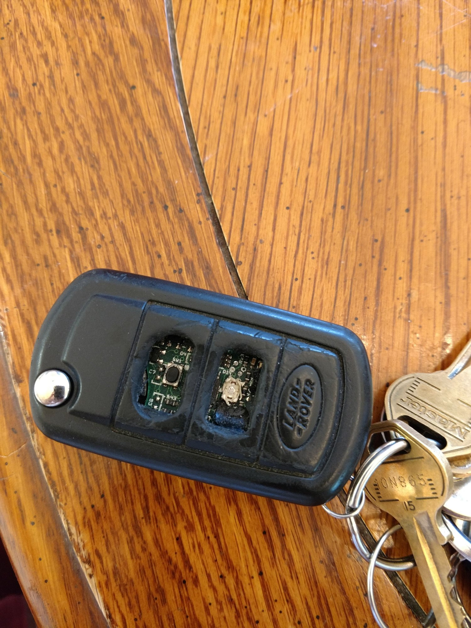

Our key has failed losing its square inside button as shown.So need OEM complete now.

But the actual button on the circuit board (pictured previously) is lost.Switching this circuit board to another case won't work as button which opens door is lost now.
Oops..didn't spot the missing button. You will need a replacement with the circuit board. There's lots of inexpensive ones on Ebay and Amazon.
Not sure why I am being quoted, I said nothing about keeping the old board, less the key itself. New fobs come with new boards. Just make sure they are 315MHz. The board consists of two circuits, one for the buttons and one for the RDIF security for starting. The buttons can be totally wrecked and not work but the security part is separate. So as long as that fob will start the truck, it can be used to make more keys with a GAP tool or the like.
